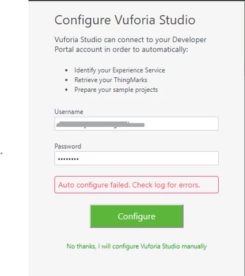

We are ensuring access to Vuforia Studio does not conflict with our company network.
Usually, if using other net (i.e. home network) an Experience Service URL will automatically generated.
However, with connected to company net, these main issues occur:
  1. Unable to configure login account
  2. ES URL not generated
IT team from my company is currently troubleshooting these issues and they already allow Vuforia access to net. But still cannot resolve the issues.

For now, we are using Vuforia Studio Trial Version.
Could you explain your question '"Where is  installed Vuforia Experience Service ?"

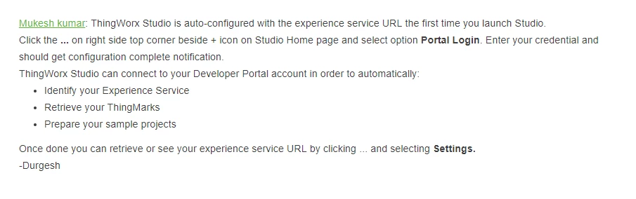

I read a post below. I am sure that Vuforia Studio will auto-configure an Experience Service URL - correct me if wrong. However, I'm not getting any ES URL even after login (also not able to login).
https://community.ptc.com/t5/Vuforia-Studio/experience-service-url/td-p/504154
I think this might cause by our company private network and our IT team still working on it.
They are asking:
"Can you check with vuforia support about what format of proxy server address they support?
Specifically in our setup the format  myproxy.myco.loc:8080"
Thanks.

  1. Vuforia Experience Service Trial version who is free with some limitations and an auto configure in Vuforia Studio
  2. Vuforia Experience Service hosted in a PTC Cloud instance. No auto configure in Vuforia Studio
  3. Vuforia Experience Service on-premise installed in an internal server in your company
So, in your case, it is the first use case.
Please attach to your post the log of Vuforia Studio where we will be able to see the error reported when trying to do an auto configure.
