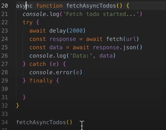

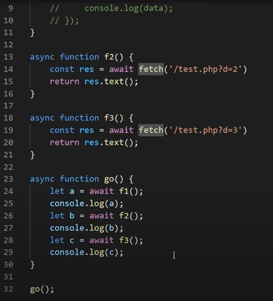

If i try to use "async function" vuforia say
! 'async function' is only available in ES8 (use 'esversion: 8').
I find some solutions like this
but it does not working in Vuforia.
