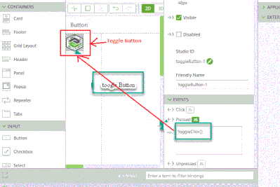

and call the toggleClick from the pressed event e.g.:
The audio file / here background.mp3  should be first uploaded to your resource folder

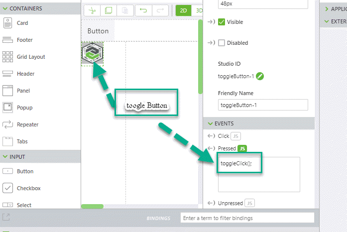

Hi @RolandRaytchev,
     Thank you for your response, I tried to create the experience but I think I am missing some trick here, can you please explain me once more with the snaps which I have provided you. Suppose I am having multiple files similar to background1.mp3 and background2.mp3 which are present in Resource folder and I want it to assign these audio files to the toggle button as that created in the snap provided, what script I need to provide in the Home.js window. So that with first click of Toggle button my  background1.mp3 file plays and with the second click of Toggle button my  background2.mp3 file plays.

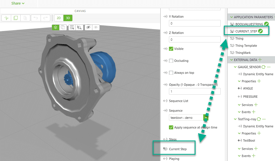

 $scope.app.playAudio('app/resources/Uploaded/seq_audio_'+GetCurrentStep()+'.mp3');
where the implementation of GetCurrentStep could be something like:
GetCurrentStep = function () {
 return $scope.app.params.CURRENT_STEP;
with:
or :
 return $scope.app.view.Home.wdg["model-1"].currentStep;
