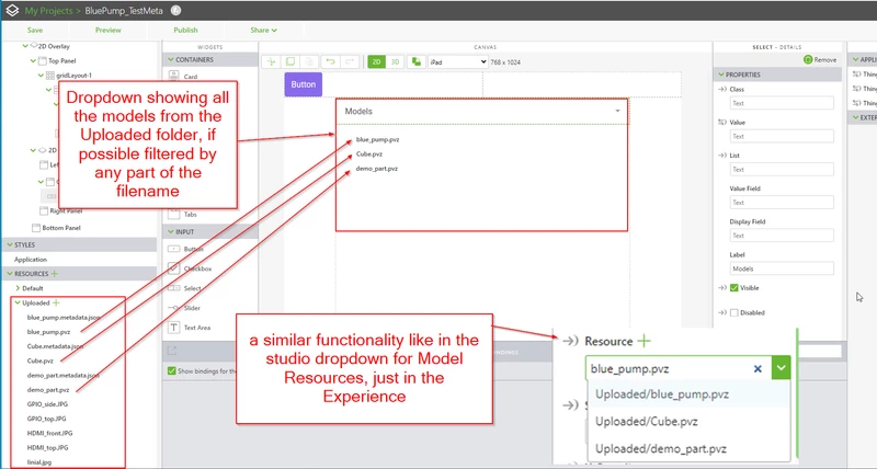

Hi community
I have a advanced question.
Is it possible to populate a list with parts from the Uploaded folder? The Model Resources selection in Studio does the same thing. But I want the View user to be able to do it, without having to hardcode the model names in JS. If we could filter the models by some part of their name, that would be even better.
Thank you for your help!
Best wishes
Alex
Nov 23, 2023 10:09 AM UTC
Hi @AlexK ,
so far I know this list is  a static list . During the Vuforia View session you can not add any files to the Vuforia Studio Project folder(loaded already in the view app) So that when you have a list in Vuforia Studio it will not change during the view session
I have a similar issue , and solve this issue by creating  a list as text file (I think better will be a json file) and then loading it when  opening the project. something like this:
my list "folderList.txt" in the upload folder
1.6,sonne1.mp4
2.3,ForBiggerJoyrides.mp4
5.6,20201103_173339_HoloLens.mp4
and used then such code like this:

Nov 23, 2023 11:57 AM UTC
I think, when you have often such tasks (where you need a list of files)  - you could use some tools to create  the list of the files in the directory /or list of  directories. e.g. node.js ( e.g. referring to link)
