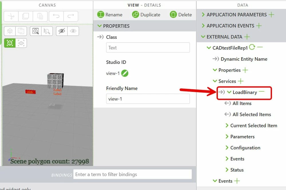

But what I think is more relevant point is to add the used  TWX services in the Vuforia Studio External data section. I tested it with different services and it will not work (also when all TWX permission are set correctly ) when the called services are not added in the Studio External data section:
anyway when you follow the suggested techniques described in Vuforia Studio Help : Create an Experience with Dynamic Model Loading it should work
