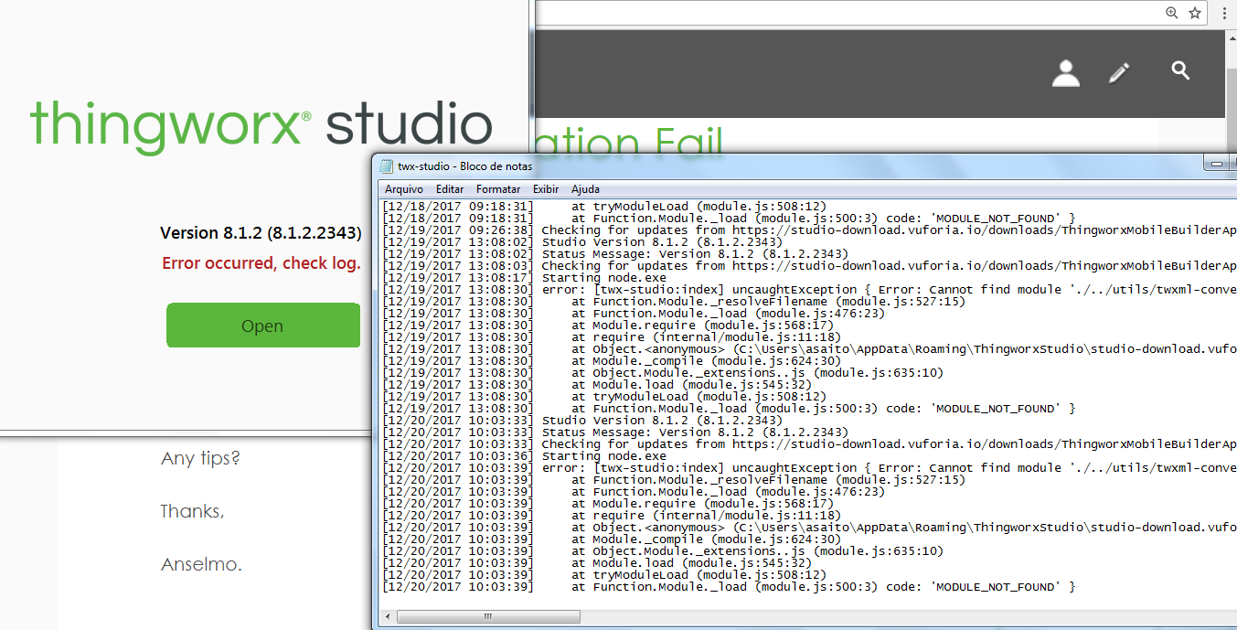

Hi All,
I am trying to use the 90-day trial verion of thingworx studio but with no sucess because of  the following error...

Hi Anselmo, Can you try reinstalling Studio? Do you have any other node.js installs on this machine?
Dec 21, 2017 5:57 AM UTC
Anselmo Saito​: Delete the files under <user home>\AppData\Local\Apps\2.0\ and re-install the studio exe file.The AppData directory is an hidden directory, make sure to enable 'view hidden files' windows configuration.
Also, make sure you do not have an external Nodejs installed as there has been known issue and conflicts reported earlier.
-Durgesh
asaito-31-VisitorAuthor
Dec 21, 2017 6:36 PM UTC
I deleted Nodejs, I mean, I removed every single thing of its components.
Reinstalled the thingworx studio, but now I am getting a new error in my log...

[12/21/2017 16:01:34]     at Function.Module._load (module.js:500:3)"
Somebody, help?
Thanks!
Anselmo.
