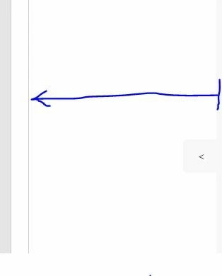

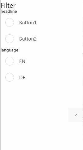

Hi everyone,
I have a 2D Project and want to make a "sidebar" that can be reduced by a button or be displayed again. I have a column, that contains a grid-layout, where all my buttons and labels are in. Clicking on the button "<" the grid layout's visibility is set to false, but the column stays at place.
Does anyone know how to make it disappear?
Cheers
whity

This is, what the sidebar looks like when gridlayout-2 is invisible, I would like to have the white area disappear and the "< " button to move to the very left.

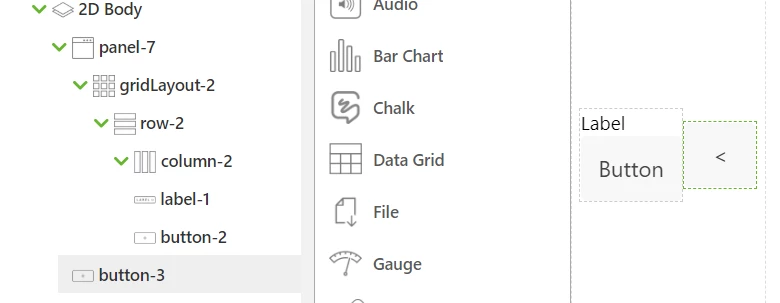

Apr 16, 2020 6:41 AM UTC
It would be helpful to see your item tree or hierarchy  as well. Also. are you using css? Then you probably have to change some properties there too. I got this working with a hierarchy like this without css:
