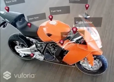

I am trying to include annotations/labels for parts in my 3D model in a way that these labels remain attached to those parts when I am moving the camera around, but have not found a way to do it in Vuforia Studio. I can add 3D labels with billboard visibility, but I cannot "attach" the label to a specific part (e.g. using lines). Looking at some PTC videos I found an example where they label parts of a motorcycle (see attached image below), but I cannot figure out how to add those particular widgets in Vuforia Studio.

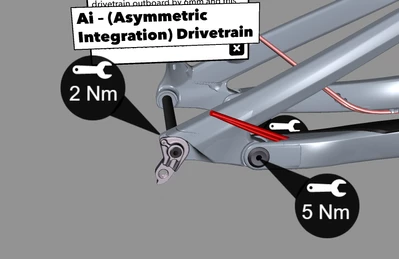

Yup @AllanThompson has the only way I know of. I would really like to see some dynamic leaders in a future release but for now it's all images with the leaders built in. I do this a lot for calling out bolt torques, I have the bubble shown below with the pointer in 4 different radial positions and use as needed.
