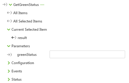

Hi Ankit,
I want to upload data in service, like the greenStatus.
So I write codes like this.
  1. var a = $scope.app.mdl['LEDs'].svc['GetRedStatus'].data.params['greenStatus'];
Is that right? It couldn`t run successfully.
Thanks.
