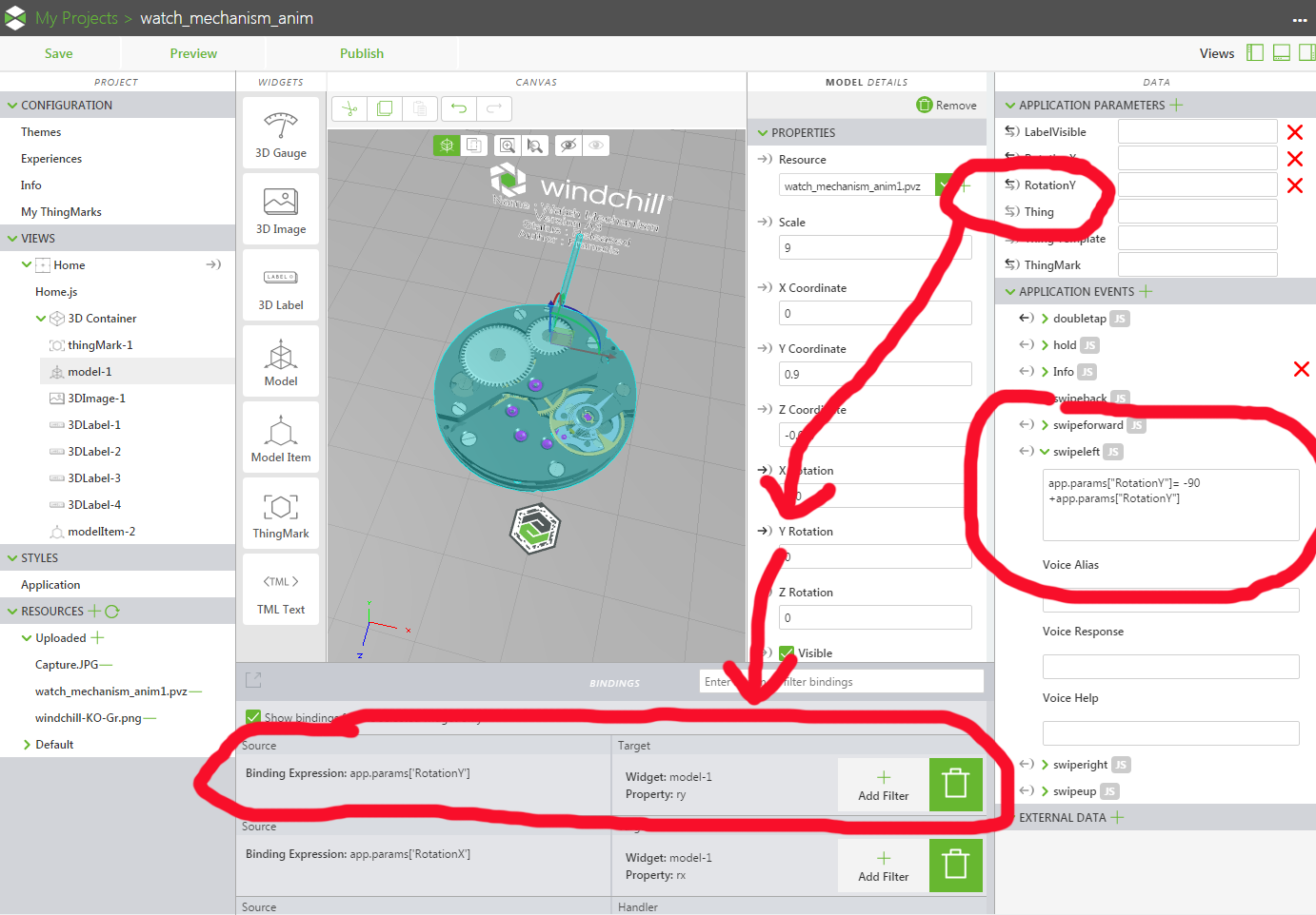

What is the procedure to manipulate or rotate a model that is viewed in the HoloLens TWX View? Is the rotation a sequence step or is there a method of getting a gesture to trigger a model rotation?

I have used a simple approach to rotate the model .  :
Create Application parameter  RotationY , bind  it with the Y Rotation in the  model
Add JS to for example Swipeleft  event :   app.params["RotationY"]= app.params["RotationY"] - 90  to rotate the model 90 Deg on Swipeleft
