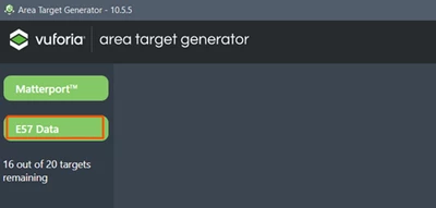

We're doing prototype development specifically navigation app. I have a vendor that help us to scan area using Matterport. One of files I received from them is .E57 file.
My question:

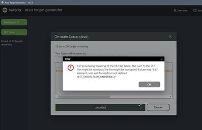

In ATG, can I use .e57 file from Matterport to generate area target file in ATG?
I got error (figure below) as I use .e57 file in ATG
As far as I know, Matterport account with professional license subscribed is needed for this. Since I have .e57 file, I thought I could use it without purchase the license as this is our proof-of-concept development.

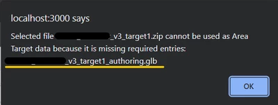

Hi, you can rename the <target_name>_authoring.3dt to <target_name>_authoring.zip.
Then open it and copy the authoringMesh.glb out of it and rename it to <target_name>_authoring.glb.

I believe this is not possible yet.
Your vendor needs to do what is written under "Retrieving Models with the Matterport™ API Token" here:
https://library.vuforia.com/scanning-environment/area-targets-matterporttm-scans#retrieving-model
and send you the Token ID, Token Secret and Space ID.
Then you can generate the Area Target.

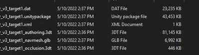

We asked our vendor to use ATG with their Matterport™ API Token and they already sent us the output file.
Below is content of the file I received.
However, I received .rar file instead of .zip, so I just de-compress and re-zip it back.
I uploaded the zip file in Vufoia Studio but having below error.
I would like to confirm on what is the output of ATG?
Is ATG generate multiple files and we need to manually zip it? If so, they might miss the _authoring.glb file (or any other possibilities)?
Thanks.
