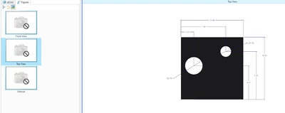

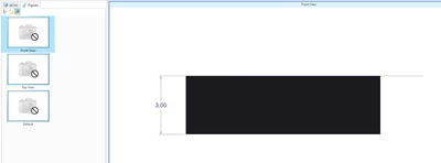

1. I created a simple creo 6 part with two different states are Front, Top + Default
2. Saved as a PVZ file
3. Imported in creo 6 where all the states were listed
4. crated one picture with respect to view along with dimensions
5. Published as PVZ

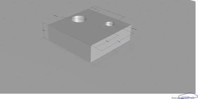

6. Created new project in VUFORIA
7. got the sequence and added list button to show
8. when I activate the dimensions are displayed but the model was not positioned as expected. the deviation continues when I use camera to capture the change position of a model during animation capture.

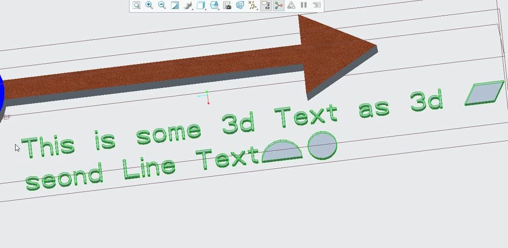

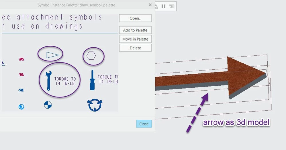

The main idea here (what was suggested) for the workaround is to use 3d components in the sequences /the steps instead of 2d symbols. This means that for each 2d symbol you can  create and to add to the top assembly a 3D component. For (arrows, tools, symbols  but sometimes also for  texts and additional info)
So, the installation tools  info could be provided by adding some additional  3d components which are not part of the assembly
We can use also for some 2d symbols e.g. arrow  a 3d flat components:
Ok, for long texts is this not so good idea – so in this case the models widget could be combined with some text Area widget where the text could be displayed but in generally texts  could be implemented also in 3d components

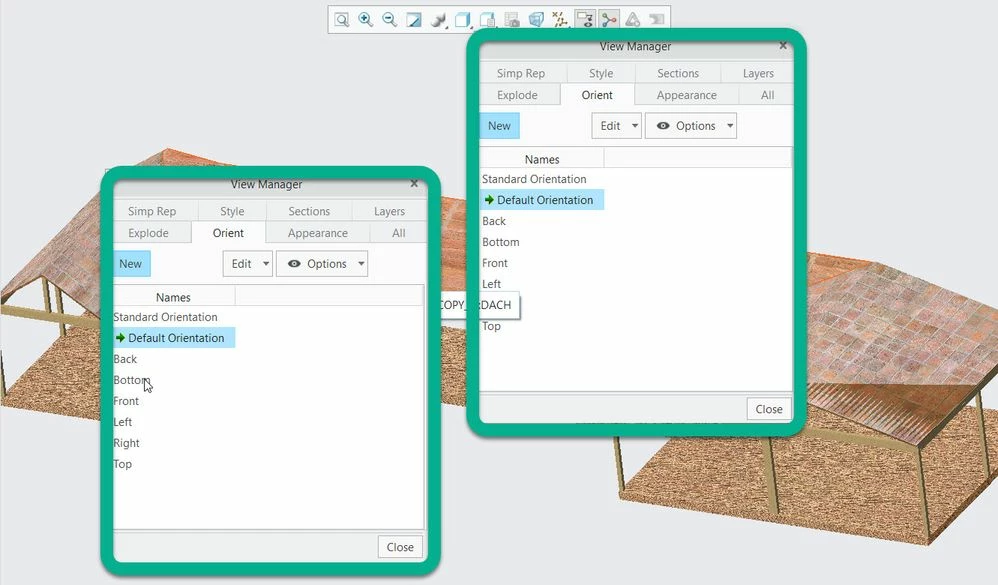

in Vuforia studio, so far I know we do not have support for MTB states, all this functionality what we know if open the view manager of Creo Parametric - here in 6.0.1 e.g.
for example if you have a status of simplified representation which blanks some parts or you have annotations /dims etc.  in this case this will be saved to the pvz file. Also, the views are also saved.
But in Vuforia Studio we do not support view because this is AR. Means the geometry has a position and you viewpoint is changing based on the device. Please, pay attention that the preview mode is only rudimentary simulation of a view in a device because you do not have really a camera position and camera coordinate system - this will be simulated. Also a mouse and zoom pan operation are only helpful tool to investigate you project but has not correspondence to  the functionality on end device

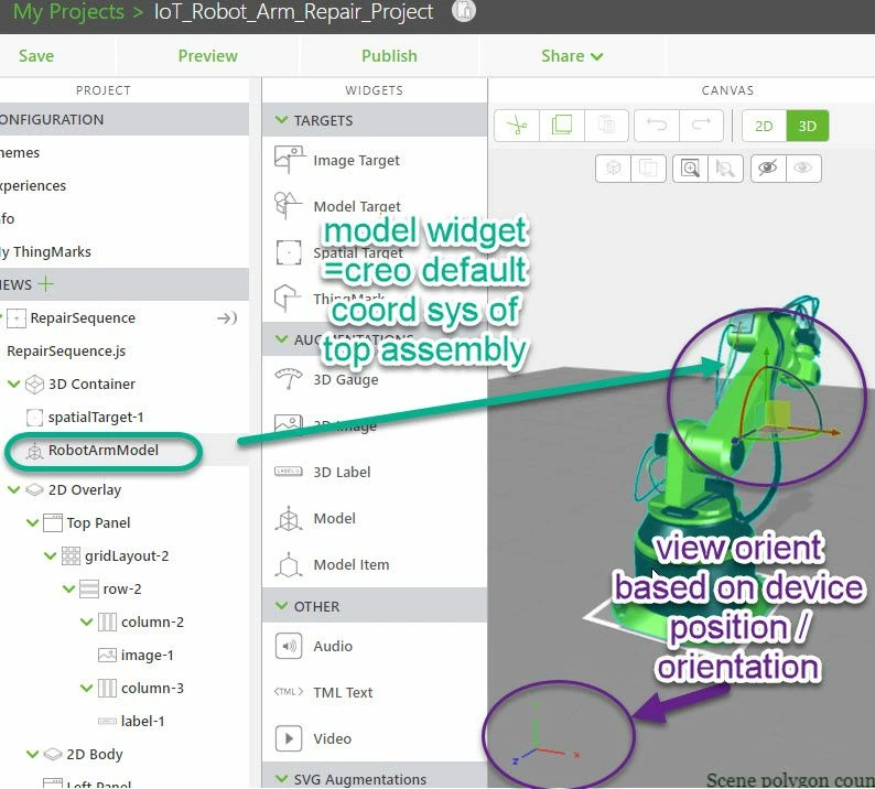

What you need to know is that the position of you model and its orientation depends only on:
1.)model (for assembly top assembly) default coordinate system. This is the system when you go in Creo Parametric in the top model and call Model>Datum> Default Coordinate System
This coordinate system will be aligned to model widget coordinate system:
Therefore when you review the experience in the view app you will see the orientation depending on the position and orientation of you device - also the zoom is based on the distance and scale.
2.) position and scale of the target (model target, thingmark, image target etc.) in respect of the  model widget coordinate system. So means when you scan e.g. a Thingmark it will fix the position of the model thingmark to the scaned thinkmark and will calculate the scale which is based on the size of the scanned thingmark and the size of the Project thingmark. Then it determines the position of the Model widget coordinate system in respect to the target and will aligned the top model default coordinate system to the widgets csys. No any view orientation will be taken in account.
But in preview mode in the chrome we do not have a real target and we do not have only a fake mobile orientation and location - so far it the zoom factor and orientation no really relevant.

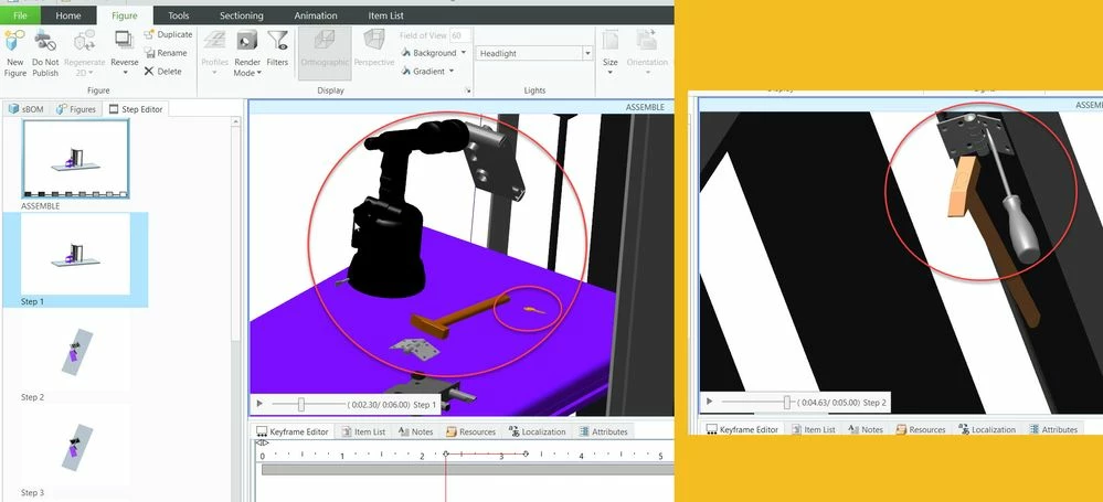

1. created 4 different pictures of PVZ and sequence in Creo Illustrate
2. loaded them into Vuforia and made a sequence player with list and button
3. when it is activated to play it does play the sequence of animation.
what is missing here.
1. I added symbol like arrow etc whis is not visible in the vufroia
Jul 23, 2020 1:06 PM UTC

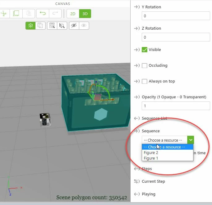

currently the sequences are working only if they are with steps. Means animation from Creo Illustrate will not work directly . So in this case you can use it inside a sequence step.

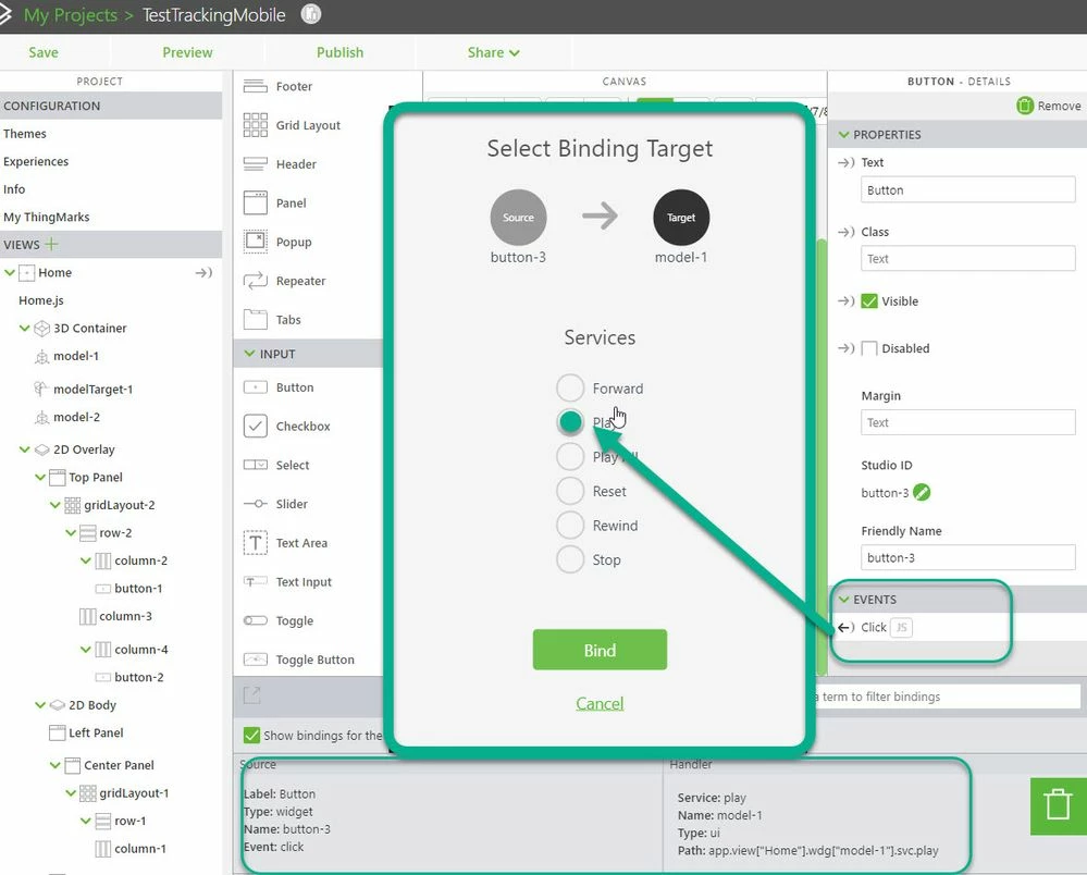

- the first think is to check if the sequence list and to set the sequence property:
Then you can try to play it via linking the play service to e.g. a button:
