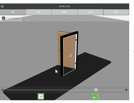

When we try to rotate a model or 3d model item about an axis it seldom rotates about the correct axis as we want.
So in this case we can help with some mathematical calculation. For example having a door assembly:
and when we  try to rotate the door model about 60degree it rotates undesired on the wrong axis.
So the first question is which is this axis and how to change it.
When we have a PVZ model we cannot really change it!
We can use some mathematical relation to get the correct appearance . In this case the correct javaScript relation should be :
$scope.simple_door_slider_change = function (angle, door_length) {
 var angle1=angle;
 var l_door=door_length;
 var angle1_rad=angle1*Math.PI/180.0;
$scope.view.wdg['modelItem-door-asm']['rx'] = angle1 ;
$scope.view.wdg['modelItem-door-asm']['y']  = 0.0 - l_door*Math.sin(angle1_rad);
$scope.view.wdg['modelItem-door-asm']['z']  = 0.0 - l_door*(1.0-Math.cos(angle1_rad));
$scope.app.params['door_angle']=  angle1;
So  calling $scope.simple_door_slider_change(70,0.950); will rotate  this particular door assembly on the correct place:
