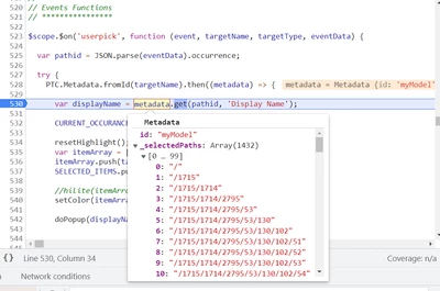

Once you have executed say for example PTC.Metadata.fromId  as shown below you can use just like standard json but the functions provided in the link by @pandersson might be easier
$scope.$on('userpick', function (event, targetName, targetType, eventData) {
var pathid = JSON.parse(eventData).occurrence;
try {
PTC.Metadata.fromId(targetName).then((metadata) => {
var displayName = metadata.get(pathid, 'Display Name');
CURRENT_OCCURANCE = pathid;
resetHighlight();
var itemArray = [];
itemArray.push(targetName+'-'+pathid);
SELECTED_ITEMS.push(targetName + '-' + pathid);
//hilite(itemArray,true);
setColor(itemArray, HIGHLIGHT_COLOR);
doPopup(displayName, pathid);
} catch (err) {
console.log(err);
