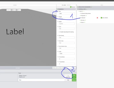

as you can see in the Video, I added some external data (axis angles) from a robot to the Hololens experience. However, I have 2 questions regarding the numbers:
1) Is there a way to modify the numbers in Studio, so that no numbers after the point are shown?
2) Is there a way to add a Unit to the numbers? When trying to add a second 3D Label only for the unit, it does not look good, because it is not connected to the number.
Thank you!

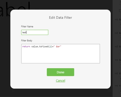

May 7, 2019 12:12 PM UTC
it's possible using toFixed() method.
Example:
var num = 5.56789;
var n = num.toFixed(2);
n=5.56
for Add  Unit to number try :
example:
$scope.view.wdg['3DGauge-1']['text']= n+" bar";
I Hope i was helpful.

May 7, 2019 1:05 PM UTC
if you have not used code to display the data then you will have directly used the result of a service and made the binding on a widget.
You must then use the Binding filters.
Bye
