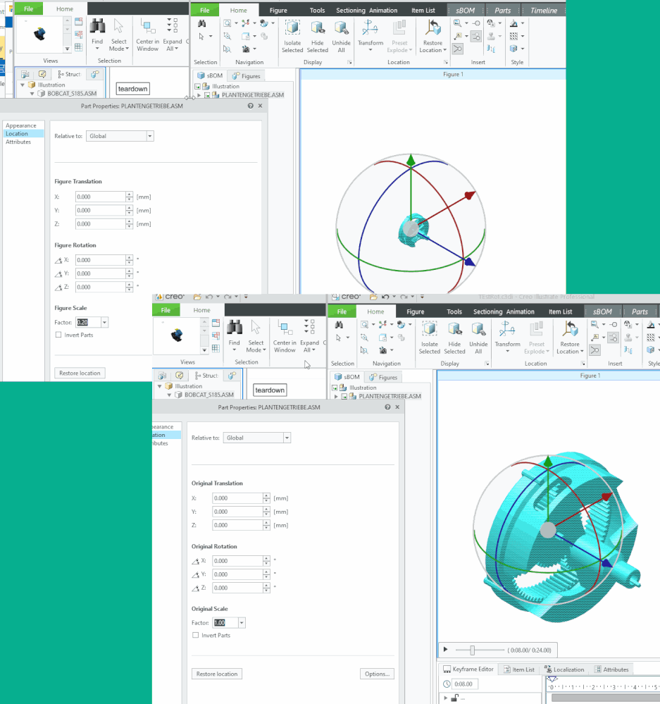

Another option is to scale the model in the cad autoring applcaiton or in Creo Illustrate
February 3, 2023
Hi @RolandRaytchev ,
Yes, scale property to scale down the model does not make a difference. I will try to reduce the scale in Creo Illustrate,
