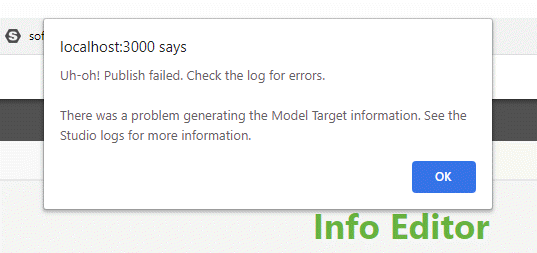

model target experience failed to publish in On Premises instances of Vuforia Studio Experience Service
i am working on vuforia studio which is installed on premises setup while i am publishing the model target with standard Model Target it shows this pop-up message as in the below image. when i open log file it shows as below text……………………...

VDP /login/token API failed with error AxiosError: getaddrinfo ENOTFOUND mtg.prod.vuforia.com

  cause: Error: getaddrinfo ENOTFOUND mtg.prod.vuforia.com
      at GetAddrInfoReqWrap.onlookupall [as oncomplete] (node:dns:120:26) {
    errno: -3008,
    code: 'ENOTFOUND',
    syscall: 'getaddrinfo',
    hostname: 'mtg.prod.vuforia.com'
::ffff:127.0.0.1 - Administrator [2026-07-23T17:47:18.974Z] "POST /ExperienceService/vuforia/model-target/signatures HTTP/1.1" 502 97 "-" "-" 108 ms win-fs8jju2bgcq.local:2019 164 [2026-07-23T17:47:18.866Z] - ms - ms - ms - ms                                                               can i get any solution for this how to solve this problem..
