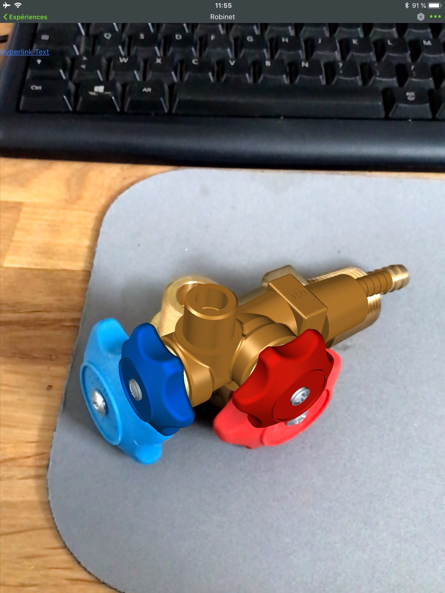

First I did a test with a customer model (see attached image "img1.jpg"). there is a big gap between the "Physical Model" and the "Digital Model". I don't know how to  explain that ?? it's very Strange!
I did some verification (Dimensions) between the "digital model" and the "Physical Model", they are fully identical!

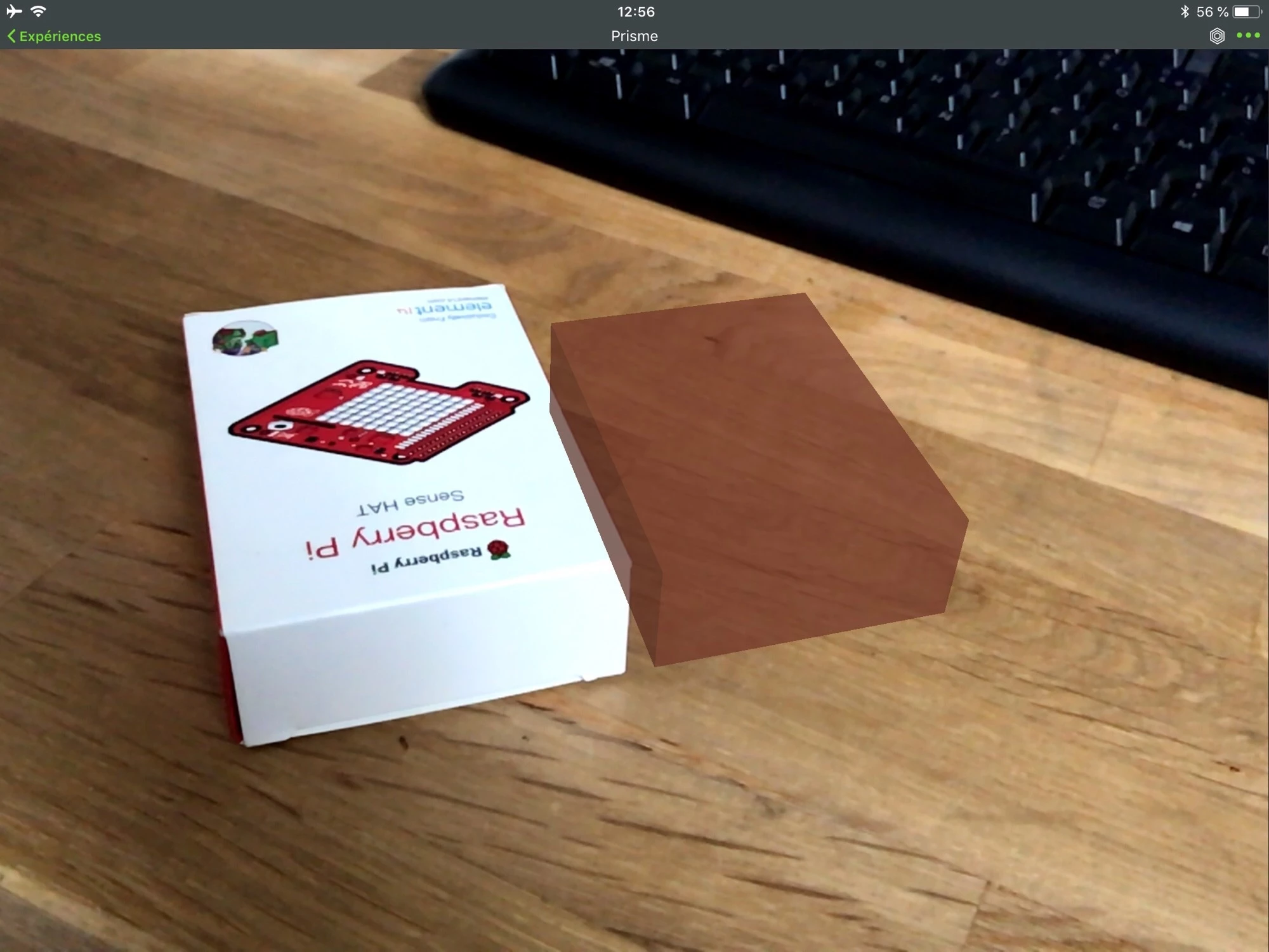

After that in a second time, I have decided to create a new model in Creo Param, just a prism (dimension according the box of a Raspberyy PI ), and I'm getting the same result, a big gap between the two models…."See the attached image img2.jpg".

The Digital Model appears directly at the wrong scale when the physical model is detected.
I can move around the model, but the scale of the model remains stable.

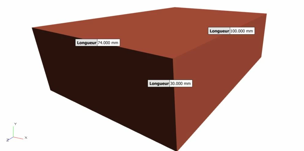

I have controlled the dimensions of the 3D model generated by Vuforia Studio, ".pvz" files located in "C:\Users\lbourelly\Documents\VuforiaStudio\Projects\Prisme\src\phone\resources\Uploaded\prism.pvz" foler. All dimension are ok. (See Image "Prisme measurement.jpg")

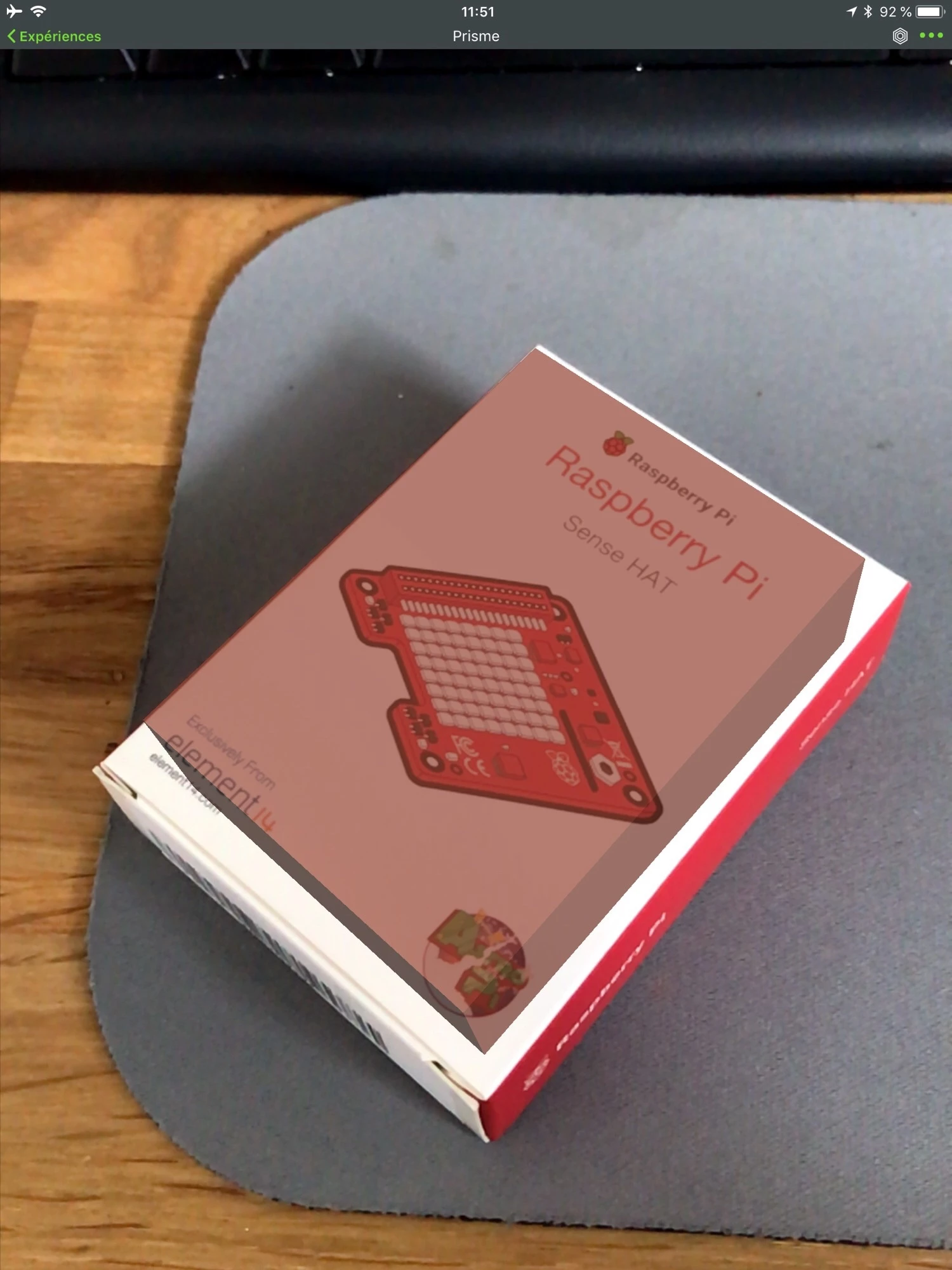

When I use a Spatial Target the model seems Smaller than the physical one. (See Image "Spatial Target.jpg")

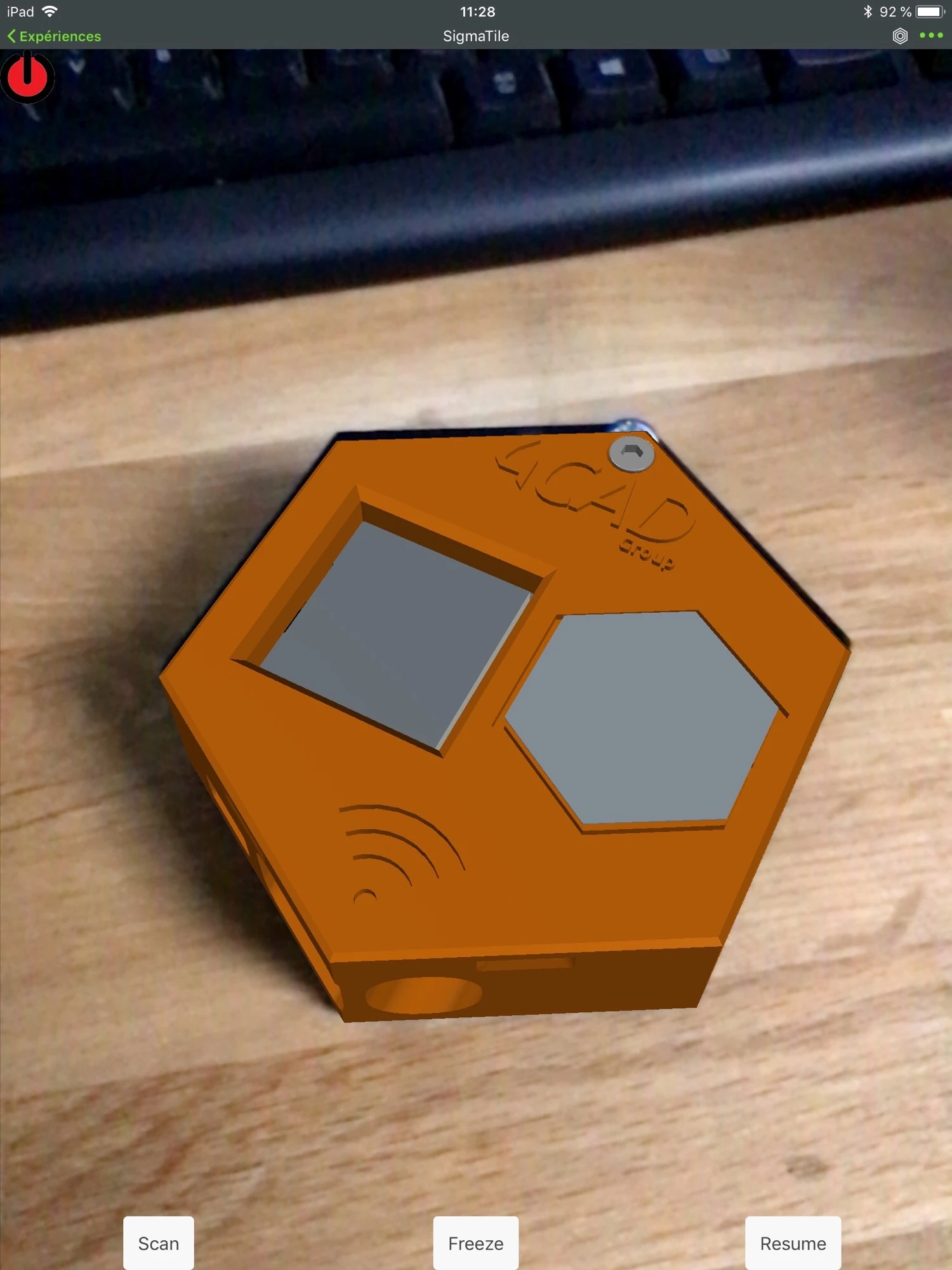

I did some tests on a "Sigmatile", it seems to be better...
