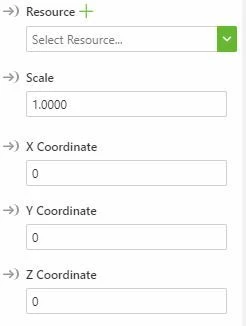

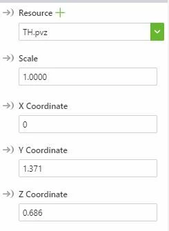

I added a model widget into the canvas with  xyz co-ordinate as say 0,0,0 (center of canvas). Now when I add the resource (.pvz file) into that widget, those co-ordinates changes by itself say (0,0.35,0.254). On what basis this is changing. When I import the components of a sub-assembly individually into the canvas, it is not sitting on the correct position. What is the best way to assemble your components inside your canvas.
Coordinates after adding resourceCoordinates after adding resourceempty model widget coordinatesempty model widget coordinates

OK now to the position. Let forget the shift what we observed when we set the resource property. We can later set the value for x,y,z,rx,ry,rz to the desired values. What means this values (In terms of Creo parametric)

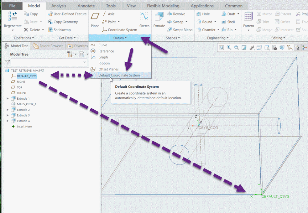

Every part or assembly in Creo Parameric has a default coordinate system. Mostly the default CSYS is coming with the template. But if there is no such you can see it when you create a new datum feature Coordinate System Default (see picture) :
The default coordinate system always exists also, when in Creo there is no explicit feature for it. And often this lead to misunderstanding when there is another coordinate system which was used for the model design but it not coincident with the default csys.
And when you add a new widget with a resource file and set manually the coordinate of it e.g. to x=0,y=0,z=0,rx=0,ry=0,rz=0 -> here this means you will set the coordinate of the model default coordinate system. This is like assembling in Creo using a coordinate system constrain. So means the coordinate properties in Vuforia are the Top assembly csys where you add coincidently the model default coordinate system:

The last point I want to mention here it the shift when we set the resource property. In this case the model “jump” to a new location. Actually we can ignore this and set again the value manually of the coordinate (so set the correct coordinate for the location of the model default coordinate system). I think this automatic shift do not have any practical value  - is not intuitive  and should be ignored.

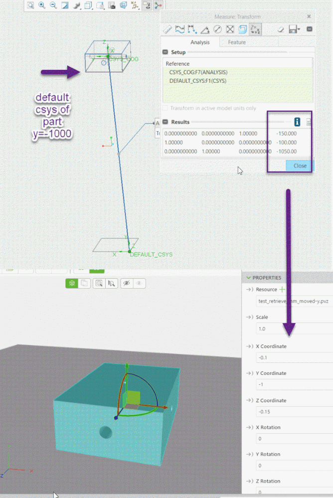

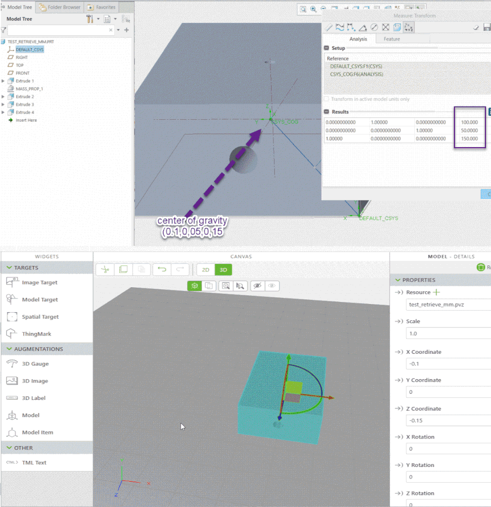

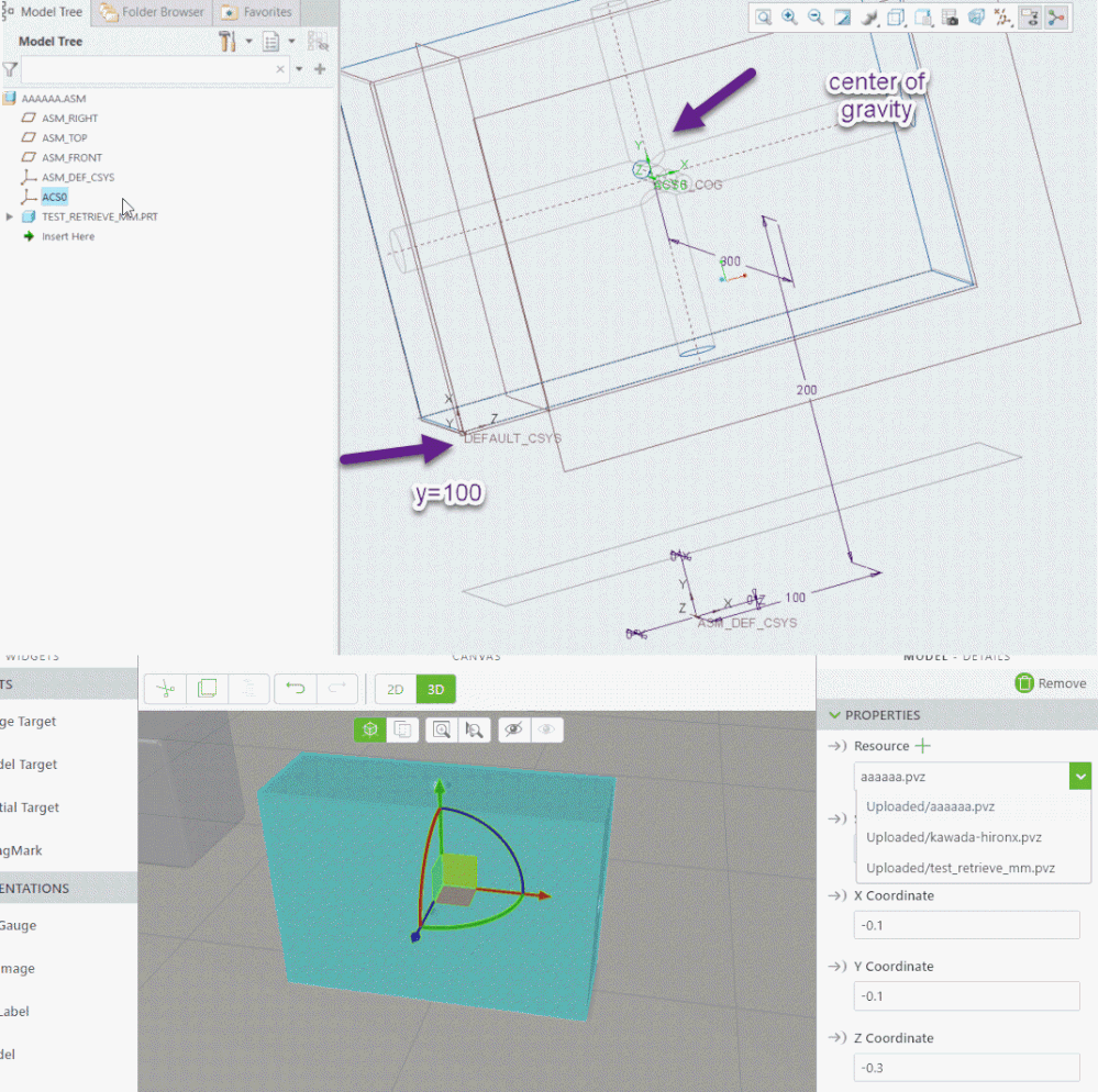

My observations regarding this shift are following:
  • For each part or assembly (particular pvz resource file) it is the same value.
  • When you add a new widget, it will go automatically on 00000 position. When you add an second, third or …. Model widget it will read the approximate coordinate of xz location and will add the new widget on the approximate x,z mouse coordinate and Y=0
  • When you set a resource file it will shift the model for specific for this particular model coordinates
The shift of the coordinates
For the x and z coordinate it will move the model so that the x,z coordinate of the center of gravity will go to the original position (when the model was originally to x=0,y=0,z=0,rx=0,ry=0,rz=0 in this case it will move the model coordinates on such manner that now to center of gravity of the part will be on x=0 and z=0. For the y position it will move the model that now the default coordinate system the model y=0 will should be coincided with Vuforia space y=0. I do not think that this is intuitive way but seem to be the current implementation.

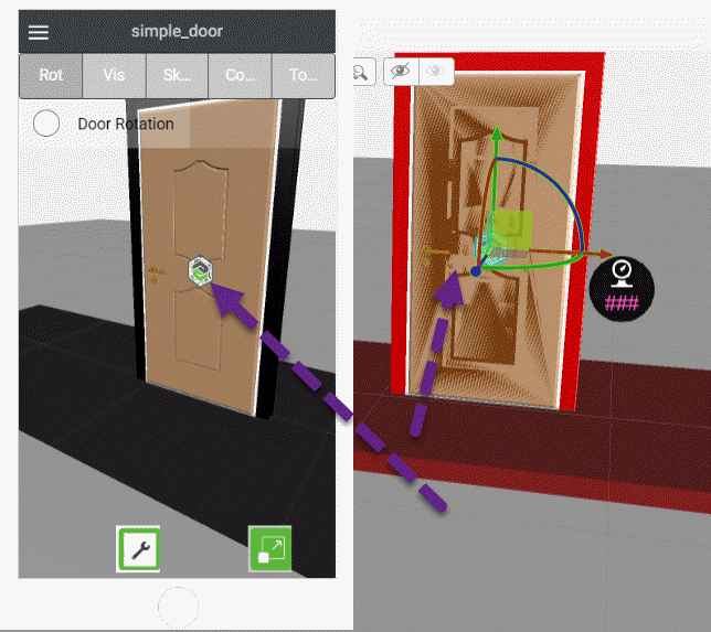

 In Vuforia studio , vuforia view  we have for the 3d models the 3d coordinate space and to pay attention of the 2d canvas display coordinates This is not our really our job. So, we do consider there only 3d model coordinates.
 Thinking in canvas coordinate we need only in the mobile 2d view where we have to design our UI - in this case it is relevant which 2d position a specific element/widget will have.
In 3d model we have a model coordinate system. In respect of this coordinate system we determine the position of all components.
 What I believe, here is the misunderstanding – is caused that you are testing only in preview mode. In preview mode the display position is not much relevant. Because the preview is only a help mode which will try to give you info about the display on the device.
The position of the model coordinate system is regarding to the target (thingmark , space target or model target but also image target)
So in you case when you create a thingmark with position , (x,y,z,rx,ry,rz = 0,0,0,0,0,0) and add a model widget also having the postion(x,y,z,rx,ry,rz = 0,0,0,0,0,0) in this case  the your model coordinate system  of the of the modelwidget  will be coincident with the thingmark.  In this case on your mobile device when you scan a project e.g. via thingmark then the model coordinate system will be coincident  with the position of the thingmark.
The Vuforia view  will check  the thingmark “width” property  and will compare it  with the size of the scanned thingmark. They should have the same size. The ratio ( thingmark size/ printed  thingmark)  will be calculated and will be used as multiplication  factor to the model scale - means it will additionally scale you model
All this factors:  position of the scanned thingmark, the relative position between the  model widget and the thingmark widget and the scale factor will determine the end position of you model on the screen – which will display it on the 2d canvas as projection.
So on end device  the thingmark of the model/ view  should be coincided with the printed thingmark what you scanned in Vuforia view.

I did some research before and this is what I noticed. Imagine you have two parts in an assembly say a screw and nut assembled using constraints.
1. I hide the nut and convert the screw alone into pvz file. I created a model widget in studio with coordinate 0,0,0 & drop the pvz file in the resource, the screw sits at some location (not 0,0,0) in canvas. I don’t do any manual adjustments on this
2. I do the same for nut. Create a model widget with coordinates 0,0,0 and drop the nut.pvz in the resource. Again, not changing anything manually
3. Now what I expected to happen was the nut to sit in correct place as it was in creo parametric, but  it’s not. Why. How can I make the nut to sit in correct position without adjusting manually, as it is a time consuming job.
