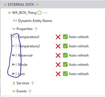

Modify thingworx data from vuforia studio
Can anyone help me how I am able to modify values in thingworks with vuforia studio? Is it possible? As you see in attached picture only one direction is available.
Thanks in advance
Janos

Hi @Janos1987 ,
yes is possible.  So far I remember two methods to set data in thingworx
1.) using a thingworx service with argument which will set the data to thingworx thing .
Here is an example with a repeat widget which togle the visibility of component
The repeater click event will call the service setCompIdVisibility. The repeater item Comp_id is bind to the method paramater. So when we click the repeater for a selected item it will call the service setCompIdVisibilitysetCompIdVisibility with Comp_id as argument and will change the visibility status in the Thingworx  this is a thing property
And in preview mode it looks like:
2.) using some Rest API which will set the data.
Here is an example of  similar service but using a REST API call

OK , it looks a little complicated but it is easy to generate this code if you use a tool like the Google POSTMAN where first you can test the Rest API request with the user Interface
And later you can generate JavaScript or node.Js programming code . The mention sample funciton above  was created using this tool.  Here the JS function setCompVis() has 2 arguments
val - /true/ false  -> depending on this value it  will call   different services to set  (true to visible -> serviceStr='setCompIdVisibility' )  unset (false to invisible - will call serviceStr='unsetCompIdVisibility')  the visiblity property of component
cmp_id -> this is the component id (syntax what is used for the modelitem widget  property->  Component Occurrence
So that the simple call of the function:
$scope.test_fnct = function(){
 $scope.setCompVis("/46/390",true);
it will call the service  setCompIdVisibility  of  the thing which have property Comp_id ="/46/390" and set the property visible to true. In this case this is  the component "vertical_beam1"

Hi @RolandRaytchev ,
many thanks it helped me a lot. I used the first instruction of yours. I run a service with Vuforia studio and it overwrites the value on the thingworx. It is so easy but i am a beginner :). Thanks a lot again.
