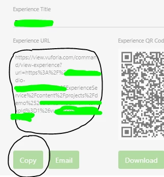

Feb 7, 2020 2:03 AM UTC
may i know how did you get to this page? or where is this page located?
Feb 7, 2020 8:59 AM UTC
to the right of the button Publish.
