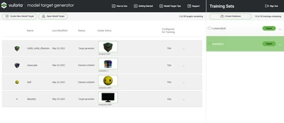

I have created model target for two object and created a database of the two object (Trained) and export the file.
I have imported the database to Unity

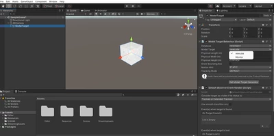

1) I have selected the imported database - here new object
2) In model target showing the two object that I have trained - here "newcube" and "monitor"
3) I have selected the new cube and added a 3d object for detection on cube - place a 3d model of rubix cube - child of model target

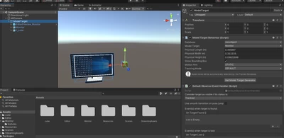

4) Then selected the "Monitor" and placed a 3d model of monitor - child of model target
But my Objects are not tracking when adding two or more objects - when adding single objects its tracking
The way I have done is correct or not for multi target object detection please help @tmccombie @Suraj_Patil
