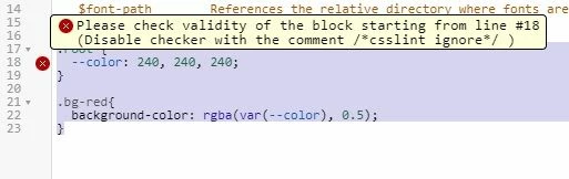

Hello friends,
is it possible to configure the Vuforia Studio to support native variables in css?
Something like this:
:root {
--color: 240, 240, 240;
.bg-red{
background-color: rgba(var(--color), 0.5);
In present time must write unnecessarily complicated code because:
thank you for every post.

Finally I found a solution for changing CSS values.
Functinon in .JS:
$scope.setCssPropertyFromJavascript= function(a, b) {
  elm.style.setProperty('--CI-LEFT', a +'px');
  elm.style.setProperty('--CI-TOP', b +'px');
In CSS first of all is required to put into the code /*csslint ignore*/.
Then we can start working with native variables:
/*csslint ignore*/

Tomas,
I'm not sure CSS Custom Properties (native variables) can be used in Studio, however you can include SASS syntax in the Application STYLES file: the file will be built to a css file using a SASS processor.
So, you can do something like this:
$color: rgb(240, 240, 240);
.bg-red {
 background-color: $color;
 opacity: 0.5;
The CSS Custom Properties syntax is flagged by the parser as incorrect: I can't say whether that's just a parser issue or the processor itself doesn't support it.
