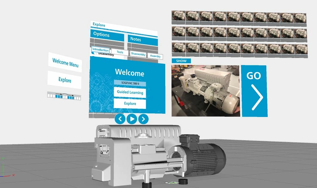

The attached image may give you an idea of how I'm stretching the current capabilities of Vuforia Studio, and have a vision for where it could go. I'm sure your team has already thought of a lot of this 🙂

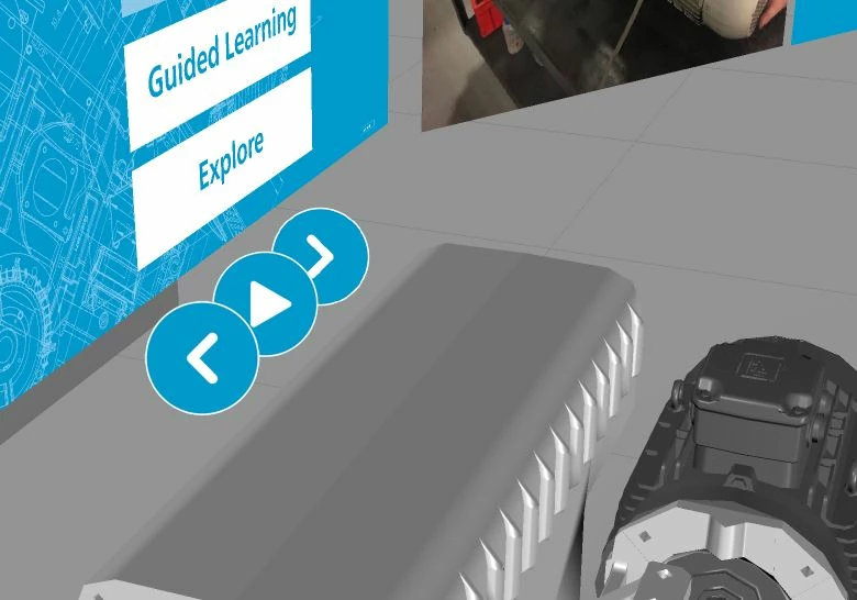

I thought of another one that would be awesome:
  • The ability to group widgets for billboard view
  • for instance imagine you have three 3D labels with clickable functionality. The first goes back a step, the second is play/pause and the third goes forward a step (in a sequence). If you make them all billboard, then when you walk around to the other side (180 degrees) the arrows will be pointing the wrong ways, and have confusing functionality. If you could group them all, and select which one would function as the pivot point (or average the center) then they could stay in the proper R-to-L order no matter where they were viewed from. please see attached image
  • The principle same could be useful for grouping to create a dialog box and some associated widgets that are placed in the same 2D plane.

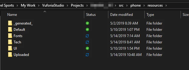

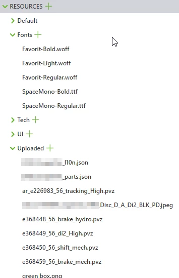

@Wes_Tomer you can already add folders as needed to Resources. You need to create the folder outside of the Studio interface but then you can view, add & remove content from them in the Studio interface. Here are some images that should explain this.
Wes_Tomer1-VisitorAuthor
May 15, 2019 9:28 PM UTC
Organization through the computer file browser - very nice tip. Thank you for this!
I first tried to create a folder within the Uploaded folder, and this did not work -- So I created a folder at the same level as Uploaded and Default and this did work.
