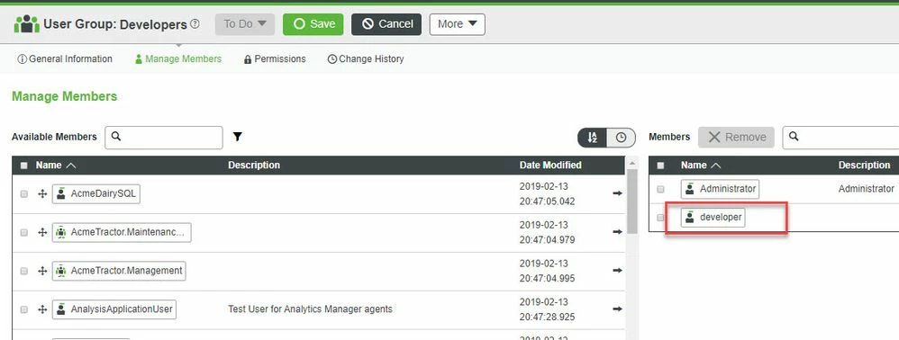

-added an user e.g. developer to the members of developer user group

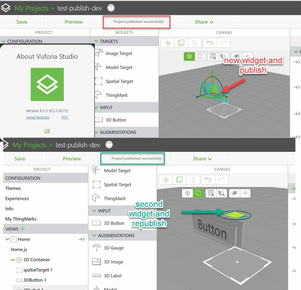

Then I  created  a new experience as developer user (member of TWX developer group) .
Published it and then created a new widget,
saved it and republished it again -this was working:

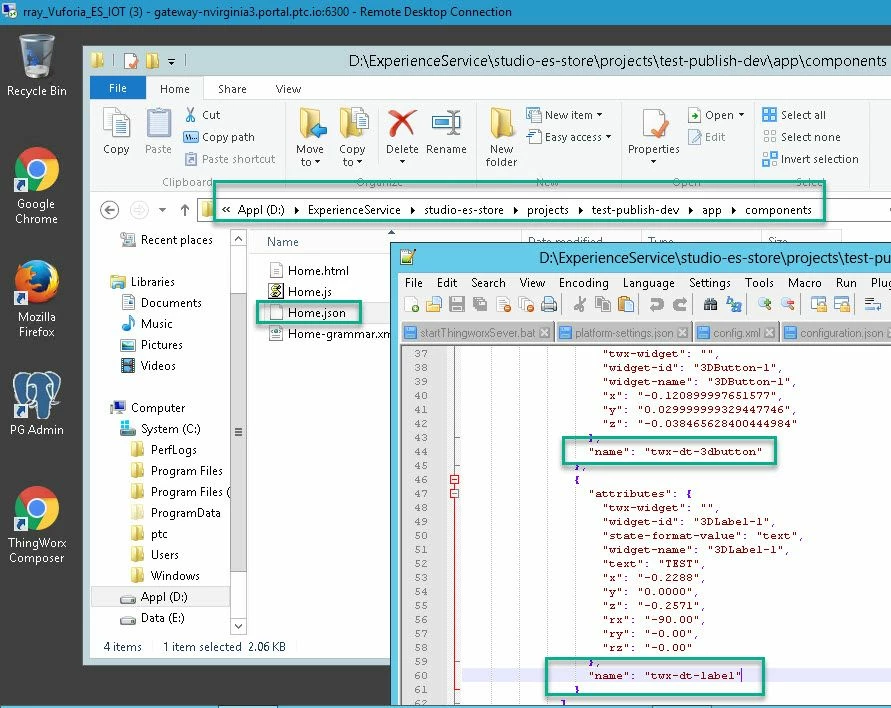

So when I check the project on the server - I could see the new widgets are updated:
