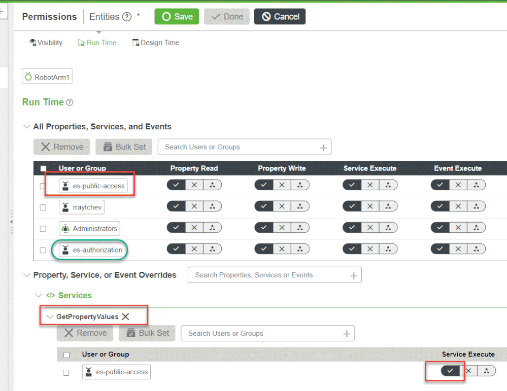

I am using spatial target to instantiate 3 D model in HoloLens. Once model appears it must display IoT values( Properties) defined in the composer. But the real time values are not appearing in the HoloLens view application.I am using GetPropertyValues service.
Please let me know how to solve this.

Hello @Desai ,
I think at first , we need to clarify if the issue is general connection / permission  , or is specific issue only to the used method.
1.)  You can check if the instructions describe in  Configuring Public Access to ThingWorx in the Help Center   and   Grant User Permissions are fullfilled . This is required when you call the project with public access (without authentication)
depending if you used credentials or not. So you allow the permission for the es-public-access user or to only specific user , or for all es-authenticaiton... etc.
3.) Another question is if the issue occurs also in preview mode - means that you will not receive the data also in chrome. In this case we need to check , how do you call this method. e.g. defintion in External data section and binding to properies, also the configuration.
