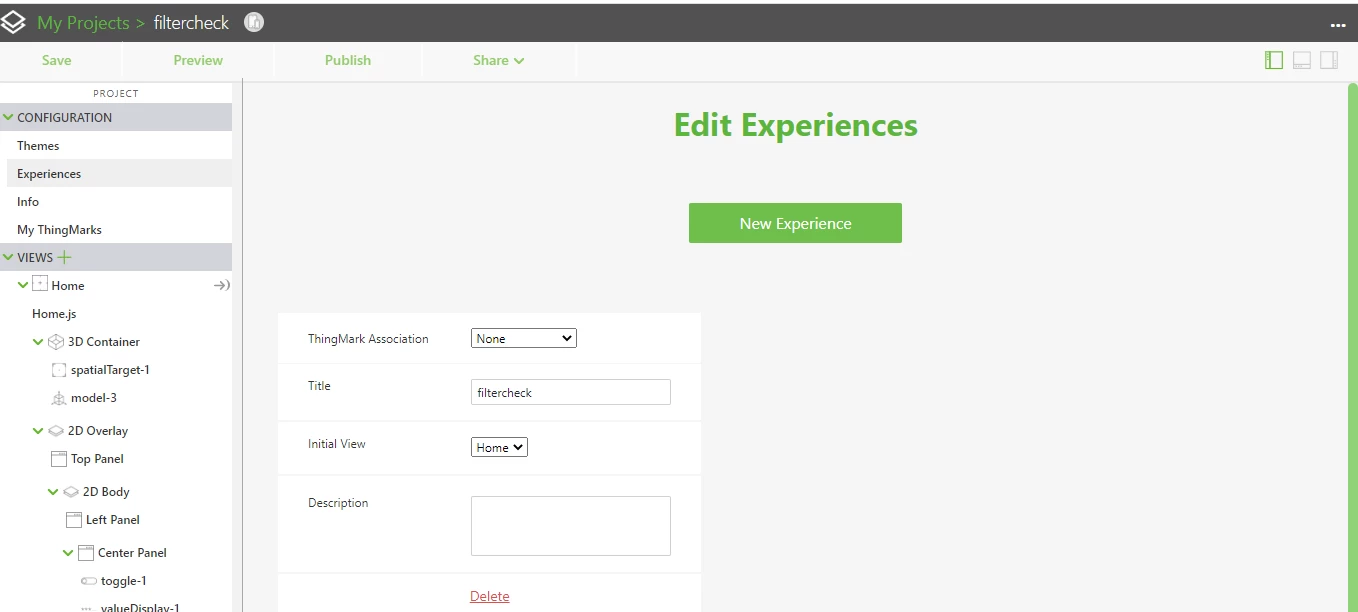

I created spatial tracking experience project. In that I can't publish the project as an experience service. I followed all the steps as per PTC guide. whenever I clicked on publish project it get stuck and not working. so please suggest me what should I do? here I attach file please check this.

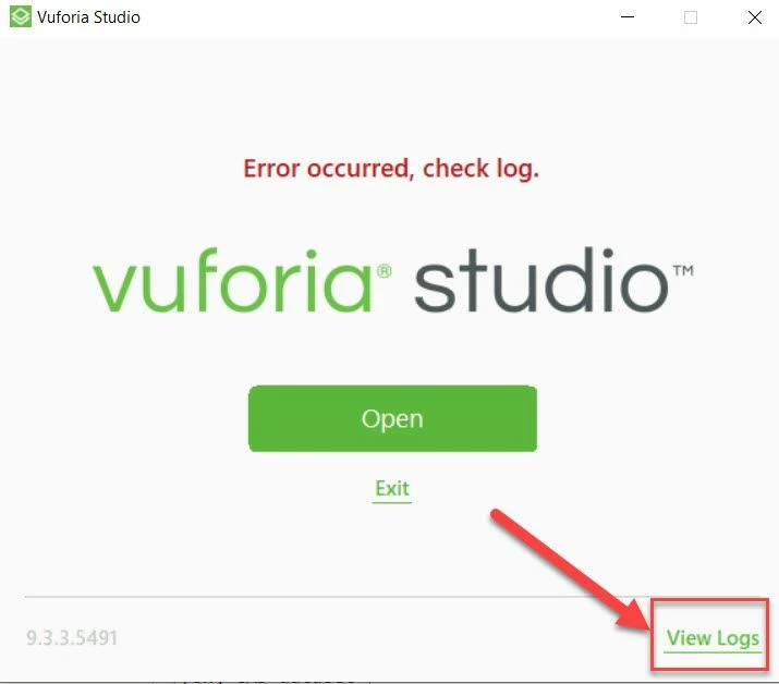

When I am clicking on validate button, I am not able to validate it. Spinner is continuously looping.
I checked in view logs, I got this error.
error: [twx-studio:versionCheck] Could not find latest version: unable to get local issuer certificate Error: unable to get local issuer certificate
How can I solve this error? Please suggest me.
Thank you

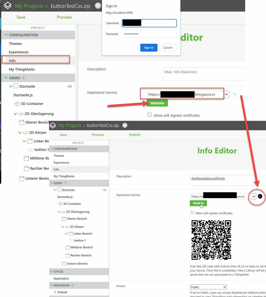

Jun 17, 2022 10:25 AM UTC
What kind of server is it?   PTC cloud server or on premises /in house installation.
When you   try to validate - what is the behavior - will it open a "sign in" dialog box (picture previous post) . Then in the dialog box you need to log in with a valid user here. Could you check, please,  if the used user is available in the Thingworx instance  and if it is a member of the Developer or Admin group according to :
How to grant users publish permissions within Vuforia Studio
and
https://community.ptc.com/t5/Vuforia-Studio/Member-of-Developer-Group-Unable-to-Publish-to-ES/td-p/627366?source=ArticleViewerRelated
