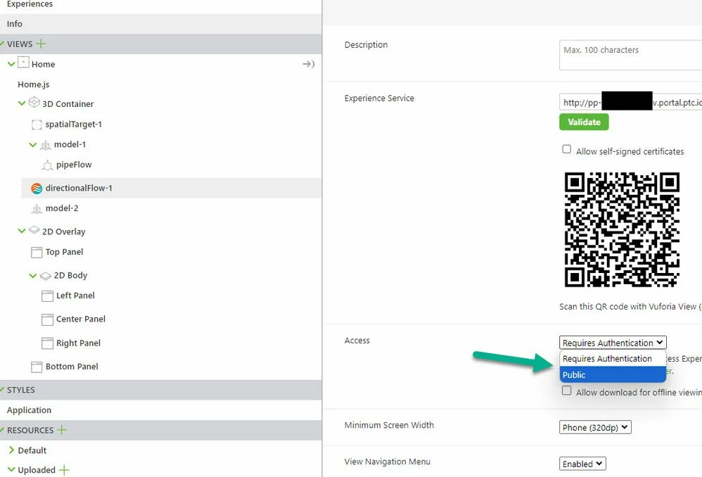

I just want to know can we transfer data from Vuforia Studio to ThingWorx without setting
public access to Things in ThingWorx. Or is there any setting that has to be done if I don't want to give public access & still transfer the data.
Oct 22, 2024 7:42 AM UTC
Hi , I believed that I answered to that question in first point of my previous post. Possibly it was not so clear.
the answer is then NO, when you published the experience as public
YES when you use user authentication /when published 2024-10-22_09-38-00.jpg
But also with published project with the optionRequires Authentication the access of TWX it will not work if you do not the set the permsissions of entites and services  according to
https://support.ptc.com/help/vuforia/studio/en/#page/Studio_Help_Center%2FAnonymousAccess.html
and
https://support.ptc.com/help/vuforia/studio/en/#page/Studio_Help_Center%2FGrantUserPermissions.html%23
so means you need to set the permission for the user grant access
