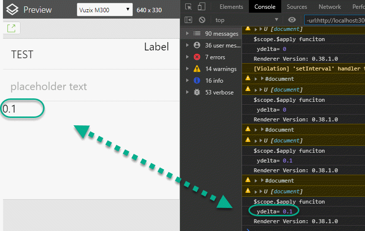

think calling the $apply before the studio is initialized will always lead to error.
This will lead  to the second problem that you Preview is not displayed properly. So, I believe when you open the chrome  console window (Strg-Shift-I) you will see some error like ...Error: [$rootScope:inprog]...
If you use e.g. the following code it should work as intented:
var ydelta = 0.1;
$scope.$on('$ionicView.afterEnter', function() {
$scope.$apply(function(){
 console.info("$scope.$apply funciton");
 if(isNaN(parseFloat($scope.app.params.ypos))) $scope.app.params.ypos='0';
 console.log(" ydelta=", ydelta)
 $scope.app.params.ypos = Math.max(0.045, parseFloat($scope.app.params.ypos)+ydelta );
$scope.goDown = function() { ydelta = -0.005; }
So tested and it worked. I  also binded the parameter ypos to a label widget and it was updated properly :
var ydelta = 0.1;
