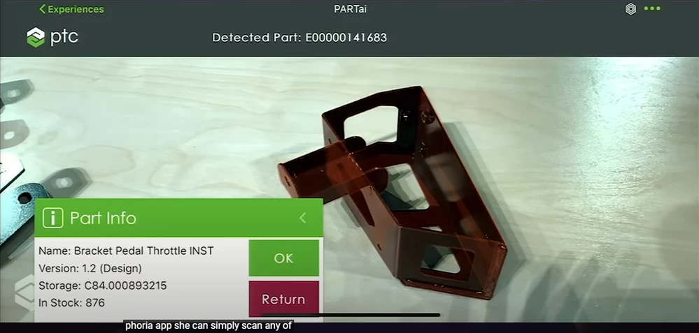

May 21, 2020 1:36 AM UTC
Hi, Wilson
Thank you for the clarification.
Because Jim said "Using Vuforia APP" in the video, and it does look like Vuforia View.
https://www.youtube.com/watch?v=4PLP3ex_8MQ&t=20m56s
I want to know if I have missed something there.
Best regards,
ClarK
May 21, 2020 1:55 AM UTC
Hi Clark,
If you notice carefully, there is a "Vuforia" watermark at the bottom left corner. That simply suggests the use of Vuforia Engine. I believe there is some customization of Vuforia View app in the demo.
