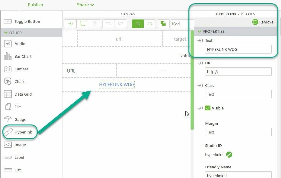

Hi everyone,
in my project actually I used to open a web page with the following code:
$scope.app.openConfirmationPage=function(url){ //passo url con pagina per conferma dati
	 try{
		$timeout( () => {var ref = window.location.href=url;
 twx.app.fn.addSnackbarMessage("window.location.href="+window.location.href,"twLogo");},500)
 	catch(e){
 	alert('redir failed ' + e);
and it's all working fine.
So, I don't want to open the browser into Vuforia View but open for example Chrome, or Safari or other platform.
How could I do?

Hi @leonardosella ,
you can try to add in your project a hyperlink widget. So far I remember (tested on IOS in the past)  this will change the behavior also when you try to open the web link  via the setting of
 (so in this case the hyperlink widget could stay invisible)
Oct 30, 2020 9:15 AM UTC
I don't understand. Could give me an example?
Oct 30, 2020 10:07 AM UTC
what I meant was to add a hyperlink widget to your Vuforia Studio project - no further action  else:
So far I remember addting of this widget to the proejct will change the behavior in Vuforia View  on end device (at least I observed such behavior some time ago and therefore mention if it could be helpful in your case - but your need to test it)
I found one project  where I tested similar functionality. /attached here
