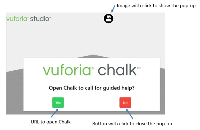

Hi, thanks for the solution, and one question , is possible open other app for example whatsapp o other app?
October 24, 2018
 Before the Chalk widget became available last week, you could use the URL vuforiachalk:// that would cause Chalk.  Se here for details.
A quick Google search tells me that WhatsApp can use the same schema: whatsapp:// and then you can add additional information to define what it will be doing: whatsapp://send?text=message
The main problem with the URL method is that it requires you to have the app installed for the URL to work.  My workaround was to have a button that gets clicked that will show a pop-up and in that pop-up you can put in any messages you want and then also include the URL to launch the app.  Here's what I have done:
You could put a message in here to say they need to have the app installed.  The new Chalk widget takes care of all this.
To make the URL look like a button, you can use CSS to format it.  See here for details.
