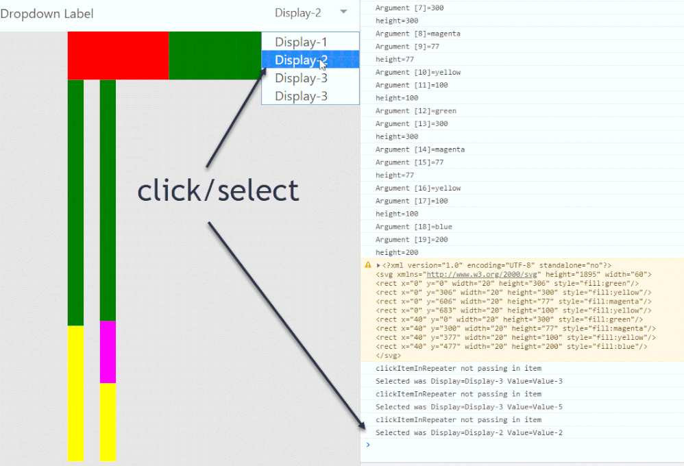

Sep 17, 2019 6:05 PM UTC
Hi @drieder ,

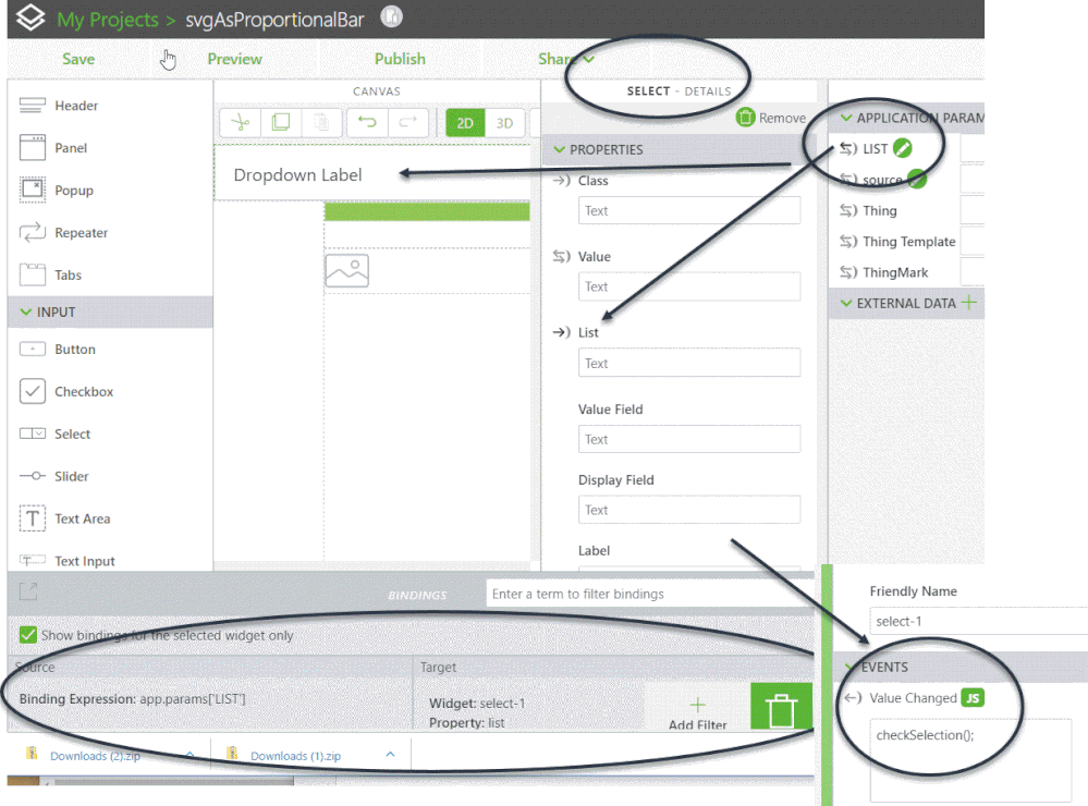

the following sample project:
where we have one applicaiton parameter named "LIST" and one select /list widget "select-1"
There is also a  binding between parameter LIST and the  Widget property "LIST" of "select-1"
There was   added to the Select widget event "valaue selected" -> the callback function  "checkSelection();"
Then added the following javaScript code:
//this function fill the list- it set the list to the parameter LIST
// and on other hand the parameter LIST has binding to the List property of "select-1" $scope.populateModelList = function() { $scope.app.params.LIST = [ { display: "Display-1", value: "Value-1" }, { display: "Display-2", value: "Value-2" }, { display: "Display-3", value: "Value-3" }, { display: "Display-3", value: "Value-5" } ]; } //$scope.populateModelList();
//call the init of the list after the view was displayed $scope.$on('$ionicView.afterEnter', function() {$scope.populateModelList();}); //this is the function for the value selection event of the widget "select-1" $scope.checkSelection = function(){ var selectedValue= $scope.app.view['Home'].wdg['select-1']['value']; var List = $scope.app.view['Home'].wdg['select-1']['list']; for (i = 0; i < List.length; i++){ if( selectedValue == List[i]['value']) {console.log("Selected was Display="+List[i]['display'] +" Value="+List[i]['value']) //handle somehow the slected item of the lists here both display and value } } }
Tested then in preview mode:

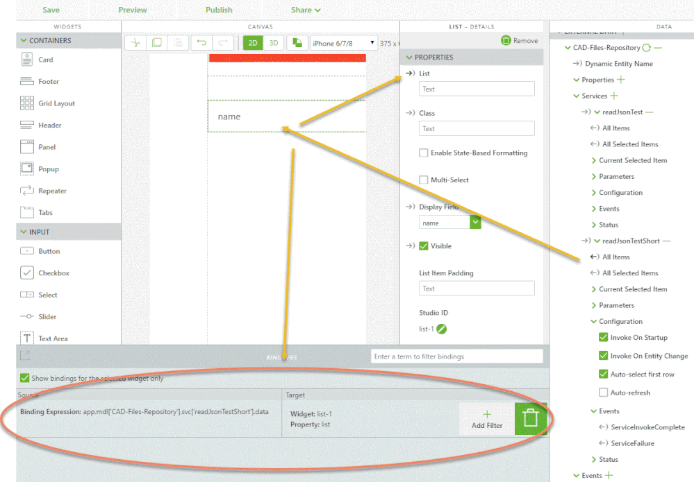

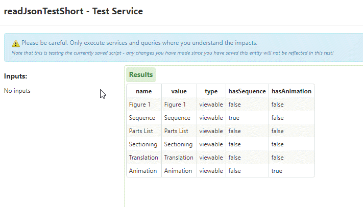

I tested with a service e.g. here readJsonTestShort which returns a InfoTable:
Then added the service as External Data:
And it is correct - then you can find the object of the current selection in the :
$scope.app.view['Home'].wdg['list-1'].list.current
Which contains the whole object for the fields with values for the selected row - dataset of the used InfoTable

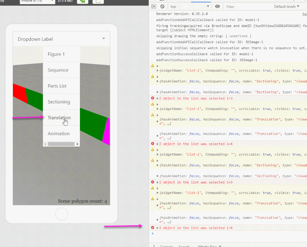

In case that you need the number i of the selected row you can use the following construct in the function called by the ItemClick event e.g. $scope.testList()
$scope.testList= function()
var current_object=$scope.app.view['Home'].wdg['list-1'].list.current
// this is json for the selected row
for(i=0;i<$scope.app.view['Home'].wdg['list-1'].list.length; i++)
 if(current_object.$$hashKey==$scope.app.view['Home'].wdg['list-1'].list[i].$$hashKey)
 console.error("I object in the list was selected i="+i)
