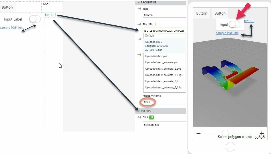

To open a pdf document from experience we can use Hyperlink widget (to open an external link) or the File widget to load/open a file from a local project directory - e.g.  the upload folder of the project
First my idea for the implementation was to use the file or hyperlink widgets  and to emit/ simulate the click event
For Example, if we have:
I used the following code to simulate the click event on both widget - to check if this will work:

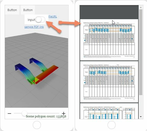

So, when I clicked on the toggle button to set it to on I could see in the chrome debugging console that the both log function are fired for the hyperlink and for the file widget.... but still it will no open the pdf files specified by the URL. So, when I click the hyperlink or the file in the UI this work without any problems.
So, after some tests I found solution but only for local pdf's. Means when the pdf is uploaded to local project folder. Otherwise we have an permission issue
In this case we do not need additional widget (file or hyperlink widget) and could call the code only from the toggle widget - I used it the short test / but also in the toggle button:
// this funciton is called from the click event of toggle widget
$scope.toggleLink = function() {
 //calling only toogle is set to 'on'
 if ( $scope.view.wdg['toggle-1']['value']==true) {
 console.log("starte link");
 window.location=$scope.view.wdg['file-1']['url']
// this above set the windows location to the url property of the file widget
// but it could be an string --> example
// window.location='Uplaoded/[BD-Logbuch]20190208-20190310.pdf'

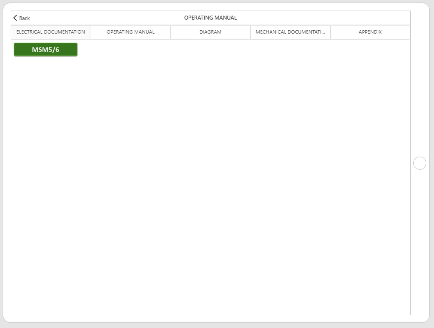

nraichura1-VisitorAuthor
Aug 29, 2019 1:35 PM UTC
I need very simple solution on following workflow
When some one click on MSM5/6 toggle button i want xyz.pdf to be opened which i have uploaded as a file in my project.
I have attached image for your reference.
Thank you

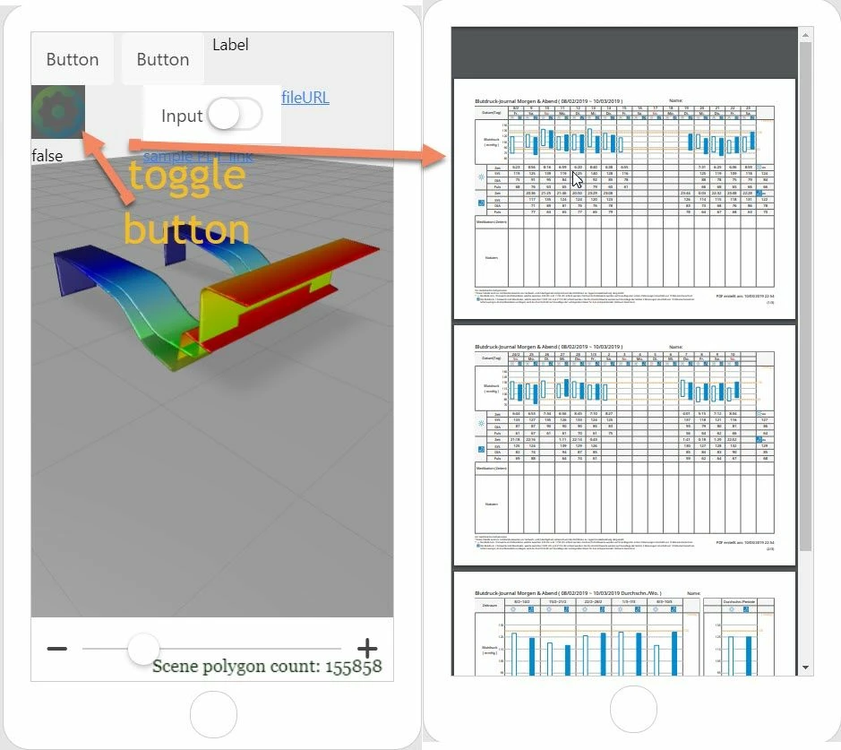

Aug 29, 2019 2:28 PM UTC
OK , this  was what the last code will do.
So I take a toggle widget for testing but the principle is working also with toggle buttong.
Here example
The JavaScript code for this :
