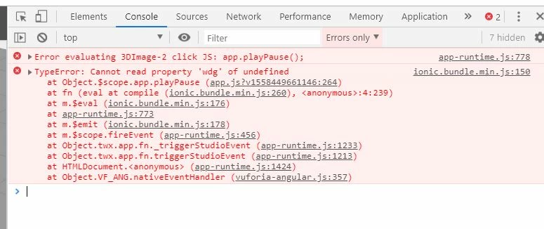

Hello All,
I know this sounds super simple, but I can't figure out how to create a play / pause function. I want a button that toggles between playing and pausing the animation. This is what I've tried so far and it's not working. I've attached the Chrome Dev tools error. It doesn't like "$scope.view.Home.wdg.pump.svc.play;"
// playPause
// Functionality: stop the sequence if already playing - or play the current step if already stopped
$scope.app.playPause = function() {
console.log('$scope.app.playPause = function()');
if($scope.app.view.Home.wdg.pump.playing)
$scope.view.Home.wdg.pump.svc.stop;
console.log('playing was stopped');
}else{
console.log('playing was started');
//app.view["Home"].wdg["pump"].svc.play
Any Ideas are appreciated!
Wes

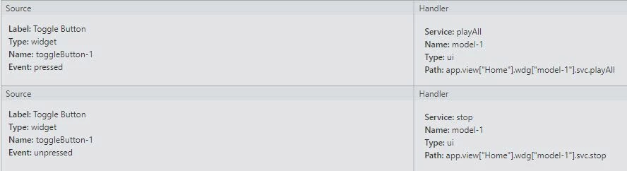

Hi @Wes_Tomer
You can use a toggle button and it's 'pressed'/'unpressed' events to do this without code. Add a toggle button to your canvas and bind the 'pressed' event to the 'playAll' service and the 'unpressed' event to the 'stop' service of your model.
