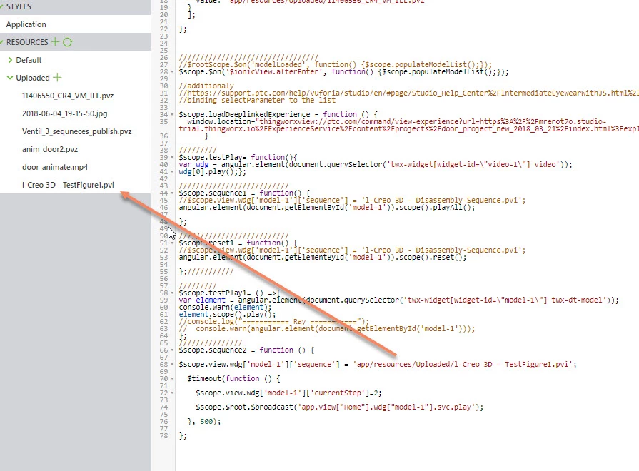

June 5, 2018
It doesn't worked for me. Has anyone tried this?
I tried this:
$scope.sequence2 = function () {
$scope.view.wdg['model-1']['sequence'] = 'Uploaded/l-Creo 3D - Figure2.pvi';
  $timeout(function () {
    $scope.view.wdg['model-1']['currentStep']=1;
    $scope.$root.$broadcast('app.view["Home"].wdg["model-1"].svc.play');
  }, 500);
But it doesn’t play just the step 1 or 2 every time I call the service.

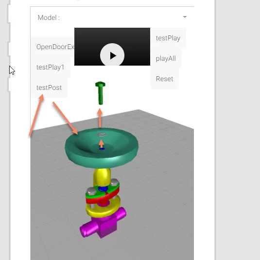

June 5, 2018
I think your code is working fine but there are 2 things to change.
1.)(consider this point only if you do not did it already)  upload the pvi file form the pvz to the upload folder - (copy name.pvz to any_name.zip and upload  the file l-Creo 3D - Figure2.pvi to the upload folder )
2.) use instead of 'Uploaded/l-Creo 3D - Figure2.pvi'  this one 'app/resources/Uploaded/l-Creo 3D - Figure2.pvi'
So I tested your script in a project :
$scope.view.wdg['model-1']['sequence'] = 'app/resources/Uploaded/l-Creo 3D - TestFigure1.pvi';
 $scope.view.wdg['model-1']['currentStep']=2;
 }, 500);
An it was working fine, The step 2 of the sequnece was started.
So step 2 of sequnece "TestFugure1.pvi" was started
