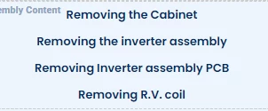

Please advise how I can link multiple buttons within one project A  to multiple Views within another project B.
When I put my code for multiple buttons/labels(within project A) linked to multiple views ( within project B) all buttons drive me to the same last in a code View. It looks like Project A for some reason ignores code for the previous Views and sees only the last one( "RemovingRVcoil")

August 27, 2023
Take a look at the 2 projects and colleague provided
MenuA is the start point and
viewlistB is the arrival
MenuA has a function below - you can see that pattern - try it out
$scope.navto = function(x) {
 // alter the expId variable by specifying the id number (see the experiences list for the other app)
 var dest = "https://view.vuforia.com/command/view-experience?url=http://pp-2301110001kp.portal.ptc.io%2FExperienceService%2Fcontent%2Fprojects%2Fviewlistb%2Findex.html%3FexpId%3D" + x;
 // and navigate to this experience
 window.location.href = dest;
