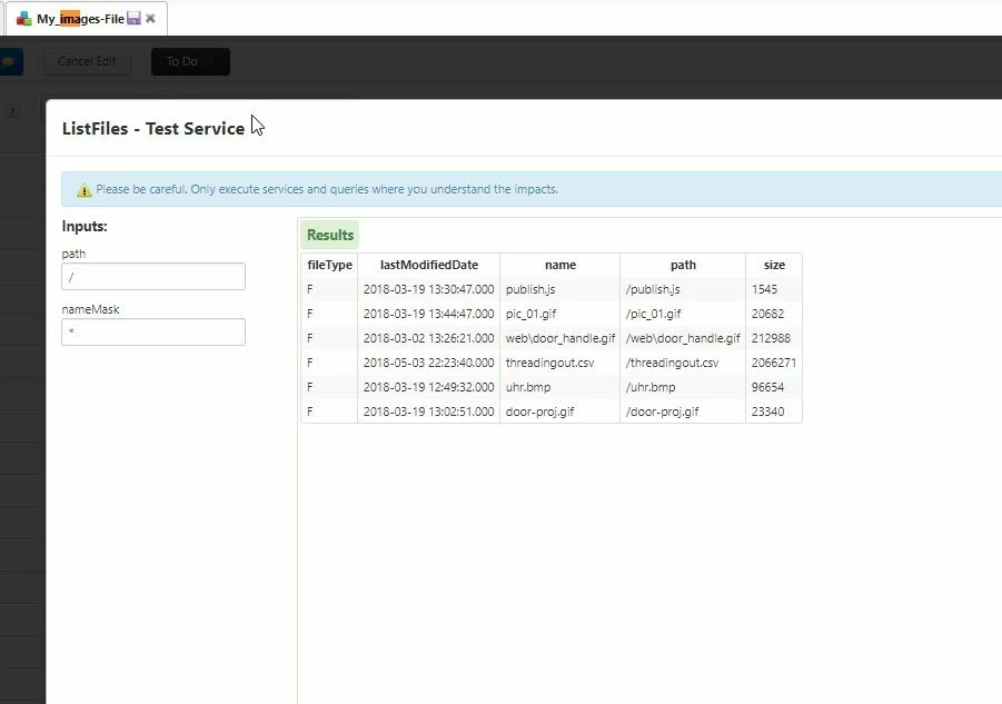

2.) How to get files from repository- I think it is possible and you can get a  image file form repository via the LoadImage service.

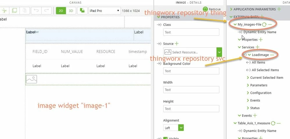

Now tested and  it was working. So have an project with a 2d image widget with the name/ id "image-1".
Also I have a Thingworx repository thing with the name "My_image-File":
In the external data added the TWX repository and the service LoadImage.
So the following code:

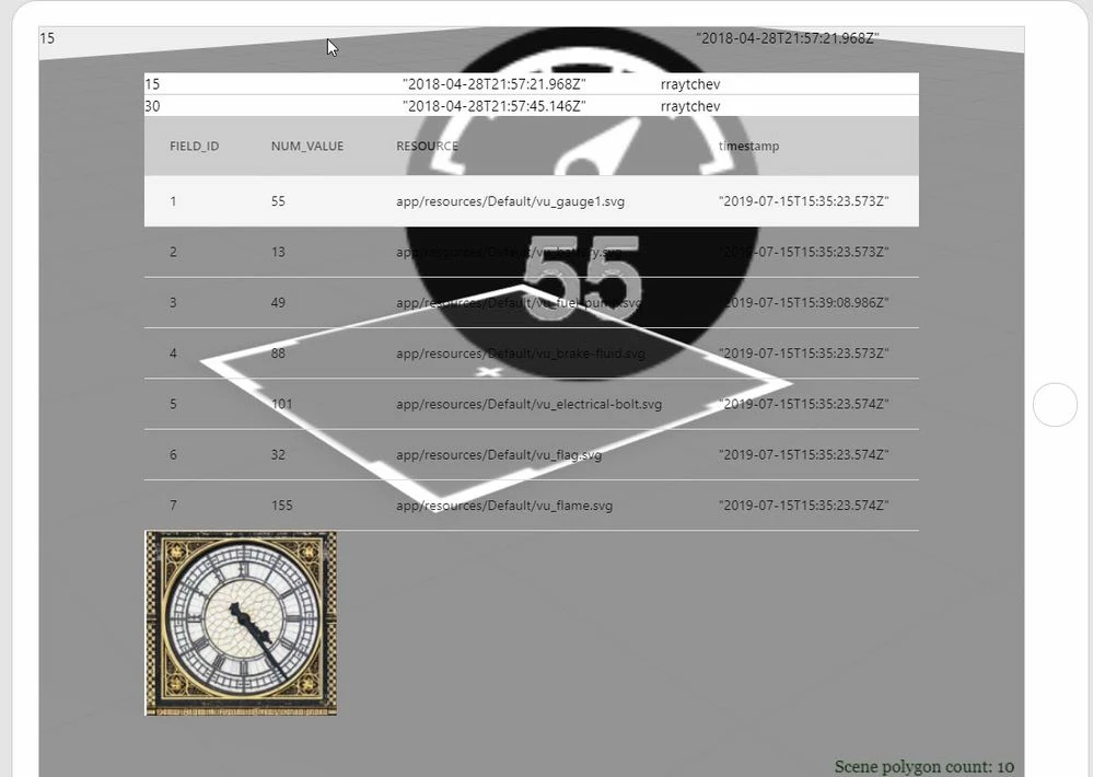

This will display the image form the repository in to the image widget:
