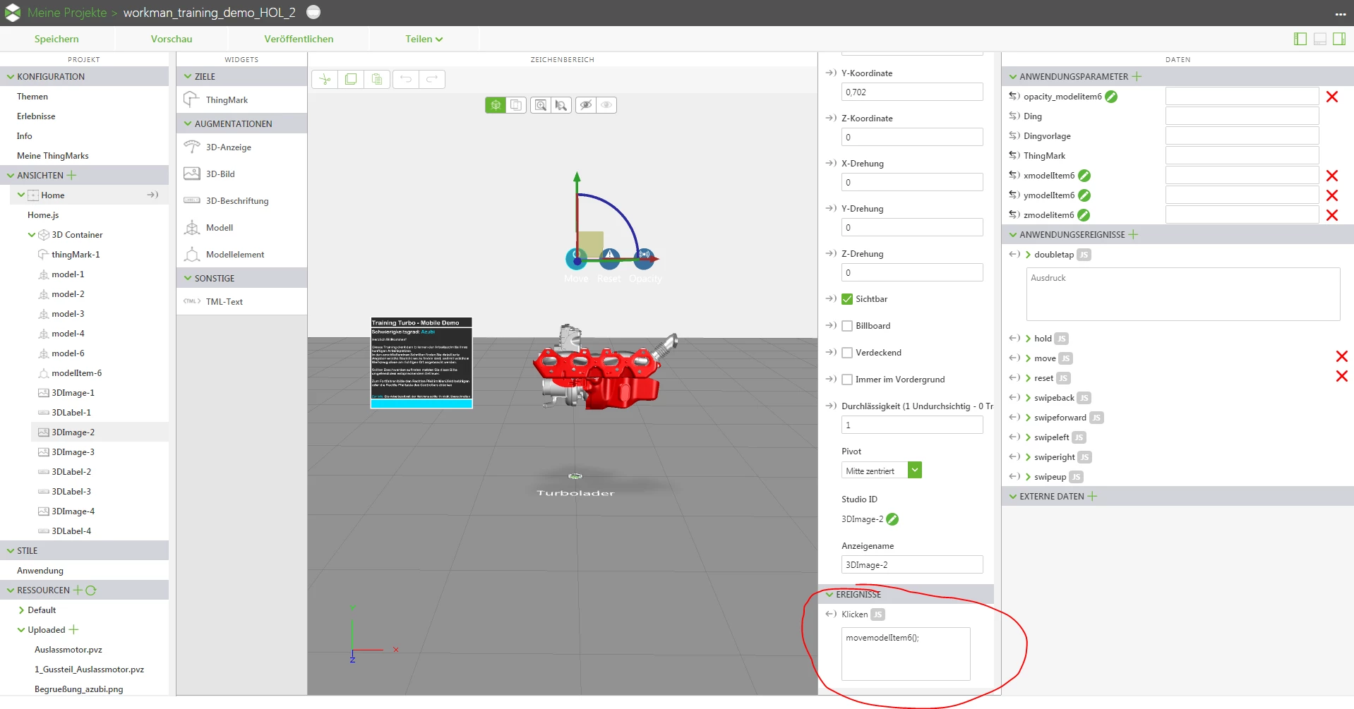

i am currently creating an 3d experience espacially for the hololens. Therefore i want to associate a 3d-picture with an even by "clicking" on the picture itself (hololens tab gesture). When using the JS application for the clicking event, the program / hololens doesnt register any "clicking" while in thingworx view. In consequence i cant start the desired event.
Is there something i am missing to trigger the functionality as "button" for a 3d-picture/object in an 3d environment? Voice Commands do work absolutely fine though.
Btw.: The command for activating the desired function in the additional picture is wrong - i know. i am using viewCtrl.movemodelItem6(); now.

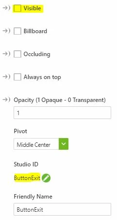

try implementing the Code in the Home.js. This could look like the following code:
var visibilityswitch=false;  //a switch, that turns buttons on or off
$scope.functionButton1 = function()  //functionButton1 is the function, that has to be called when pressing Button 1
visibilityswitch=! visibilityswitch;
//The switch is turned from of to on
  $scope.view.wdg['Button2']['visible']= visibilityswitch;
//This line makes Button2 visible when first run.
//Make sure, that Button2 (your 3D Image) is not checked at “Visible”.
//Also make sure, that your 3D Images have the right name under Studio ID, in this case “Button1” and “Button2”.
