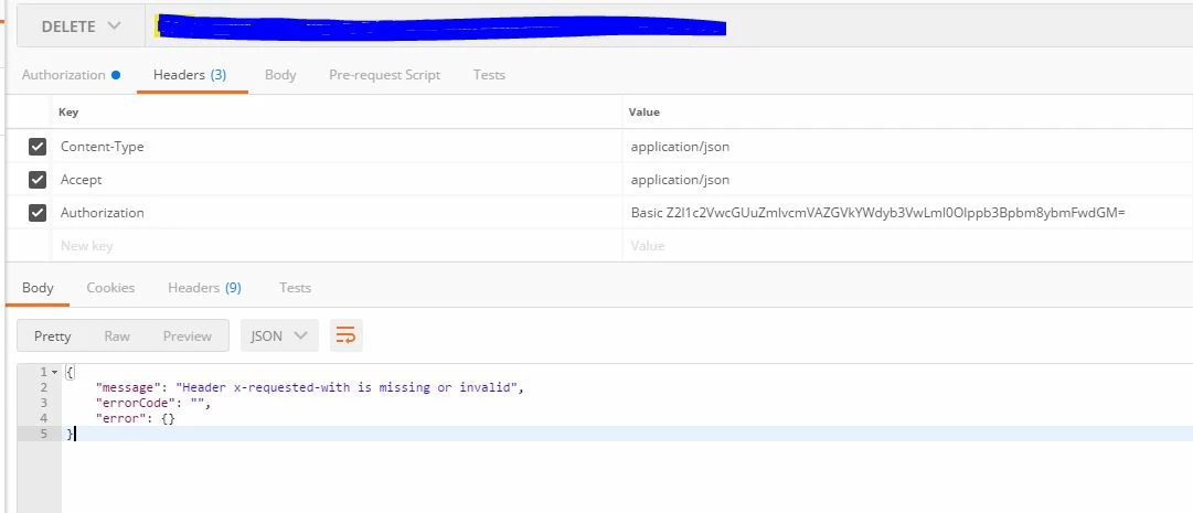

Postman Error --- -Delete Experience
I have always used Postman to delete the published experiences, but lately I received this kind of msg, which does not allow me to cancel the experience, from what can it depend? the configuration parameters are the same used until everything worked.
What has changed ?
May 21, 2018 11:34 AM UTC
Resolved.
unlike before you must also add the parameter
X-Requested-With          :   application/json
