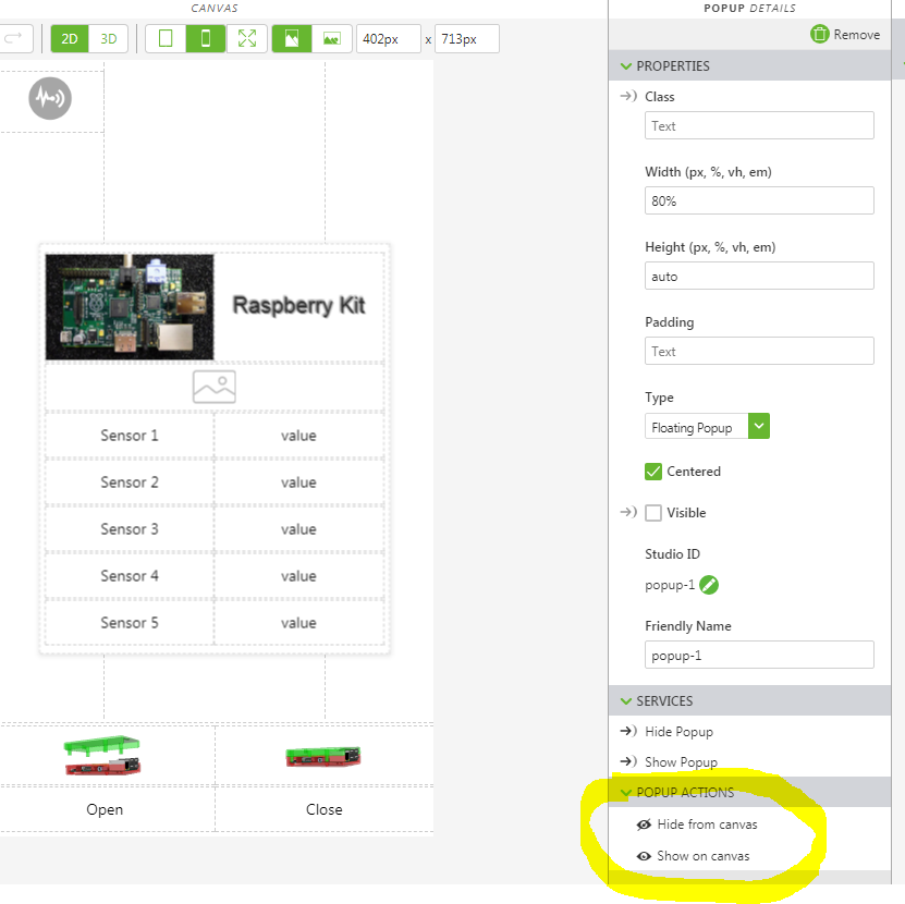

Problem show canvas/hide canvas Popup after upgrade TWX Studio 8.1.1
After upgrade to 8.1.1 , does not operate the show/hide on canvas option for the popup widget.
is it just my problem?
Thnx

    Giuseppe Fiore​: Could you please attach the snapshot describing the issue as do not see it locally.
    Durgesh
    Nov 17, 2017 10:23 AM UTC
    In the previous version of Thingworx when I selected a popup and used hide on canvas,
    the popup disappeared to work on the underlying widgets, now with the upgrade to 8.1.1 the
    hide & show option does not work, the popup is always visible on the canvas.

    I have the exact same problem since the 8.1.1 update

    Bob Wansink​ Ankit Gupta​ - It seems to be an issue with 8.1.1 and checking for a resolution.
    -Durgesh
    Dec 7, 2017 3:05 AM UTC
    Giuseppe Fiore​Ankit Gupta​Bob Wansink​
    This issue has been noted by R&D team and has been fixed for the next release.  As a possible workaround until the fix please use the drag and drop of the widgets in the tree structure in the left hand panel is one option.
    -Durgesh
    Dec 7, 2017 3:49 AM UTC
    Thank you Durgesh Patel​ for the update. How soon can we expect the next release?
    The workaround I use is to set the size of the popup to 1px for both width and height. This hides that popup and then while publishing I resize them back to the required size.
