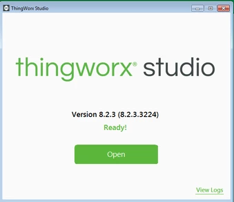

I have had Vuforia Studio all throughout 2018, and most updates came automatically in this window:
But since 8.2.3, I have not received any updates. I even manually tried update through this:
but got an error message stating "Oh no! The update failed. Check the logs for more information."
Here are the logs:
[12/17/2018 14:03:25] error: [twx-studio:versionCheck] could not determine version TypeError: Invalid Version: null
[12/17/2018 14:03:25] at new SemVer (C:\Users\rojasc\AppData\Roaming\ThingworxStudio\studio-download.vuforia.io\node_modules\semver\semver.js:291:11)
[12/17/2018 14:03:25] at compare (C:\Users\rojasc\AppData\Roaming\ThingworxStudio\studio-download.vuforia.io\node_modules\semver\semver.js:578:39)
[12/17/2018 14:03:25] at Function.gte (C:\Users\rojasc\AppData\Roaming\ThingworxStudio\studio-download.vuforia.io\node_modules\semver\semver.js:627:10)
[12/17/2018 14:03:25] at C:\Users\rojasc\AppData\Roaming\ThingworxStudio\studio-download.vuforia.io\dist\server\services\versionCheck.js:58:31
[12/17/2018 14:03:25] at <anonymous>
[12/17/2018 14:03:25] at process._tickDomainCallback (internal/process/next_tick.js:228:7)
[12/17/2018 14:03:25] GET /api/version/check 500 319.221 ms - 27

Hi @crojas,
The automatic update was turned off for the re-branding from ThingWorx Studio to Vuforia Studio. You need to uninstall ThingWorx Studio from your machine, then download & install the latest release from our esupport site. Upgrades will work as expected after installing Vuforia Studio. The latest release of Vuforia Studio is 8.3.7.
Please see our knowledge base article here about this process.
