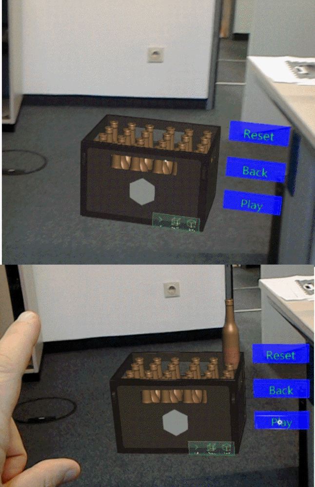

I was creating an AR-project for Hololens (1st gen), where an Air tap on a 3D- Button should trigger some javascripts and start a sequence.
While on a PC-preview the project was running flawless, during the real-case with Hololens, the buttons didn't appear.
Did someone experience this kind of a problem and eventually knows a solution?
Here's how the buttons look like in the designer-ui and on the preview

thank you for your suggestion! Tried it out. Unfortunately, it didn't solve the issue. In fact, I've noticed that some models, which should appear during animation, are also visible only in the browser preview. Seems to be a bug of some sort.

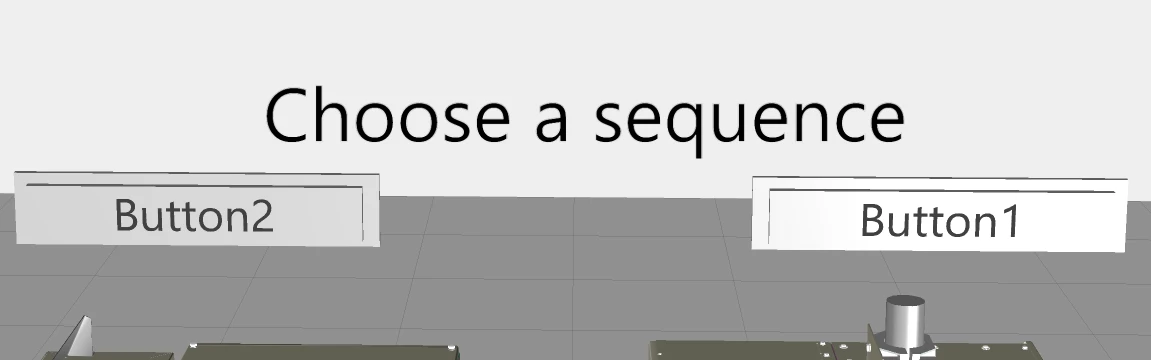

Hi @sshevliakov ,
I tested it in the current release /studio and view / but could not indetify any issue there. 3d buttons seem to work fine on the HoloLens 1 :
How did you define the 3d button. Did you use any css? May be first try only using colors without styles.
