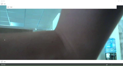

In studio and preview the styling of the checkbox is just as it should be.
I'm using just the standard, not changing anything with css.
But in the Vuforia View app the styling is different, as if there are no css applied.
That's just the case with the checkboxes, any other widget is working as it should.
I use Windows 10 with both, the studio and the view app.
Someone has the same problem? Or an idea?
See the uploaded screenshot.

As I already mentioned in my initial post, I'm working on a Windows 10 Tablet and a Windows 10 computer. We don't use ios or android at the moment, so I can not test it on other hardware.
I exported an example project an atttached it.

But in my workstation in Windows 10 with a webcam, I am able to reproduce it.windows10_checkbox_css_styles.png
So, it seems to be a bug about a CSS stylesheet not applied in the same way between web browsers used in Vuforia View in each platform.
In Windows OS, I guess, Internet Explorer is used.
In all cases, CSS is a standard and it should be applied in the same way between web browsers.
So, I am reporting a Jira Ticket to R&D about that.
