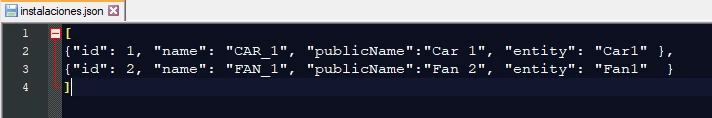

Nov 5, 2020 7:32 PM UTC
Hello @leonardosella, the solution proposed by @lgherman works correctly.
It may be that your .json file is badly formatted.
I share an example:
Kind regard.
Elias.
