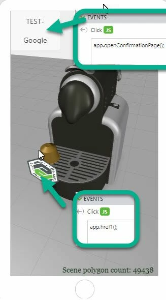

Hi everyone,
I want to open a link to a page (that could be on the interenet or intranet). I'm testing the function with an internet link (es. https://www.google.com/) but there is some problem: in preview mode I'm able to open the link, in mobile device nothing happens.
In 2D canvas I put a button that call this function:
$scope.openConfirmationPage=function(){
	let url= "https://www.google.com/"
	window.open(url)
Anyone has a solution?
Thank you.

Now tested on mobile:
- similar to your code - and it was working on both android and IOS - using the href property:
$scope.app.openConfirmationPage=function(){
	window.open(url)
$scope.app.href = function () {
 try{
 $timeout( () => {var ref = window.location.href='http://getstatuscode.com/200';
 twx.app.fn.addSnackbarMessage("window.location.href="+window.location.href,"twLogo");},500)
 catch(e)
 alert('redir failed ' + e);
$scope.app.href1 = function () {
 try{
 $timeout( () => {var ref = window.location.href='https://www.google.com/';
 catch(e)
so the test on IOS and Android couold open the google web side

Oct 8, 2020 2:20 PM UTC
It works.
