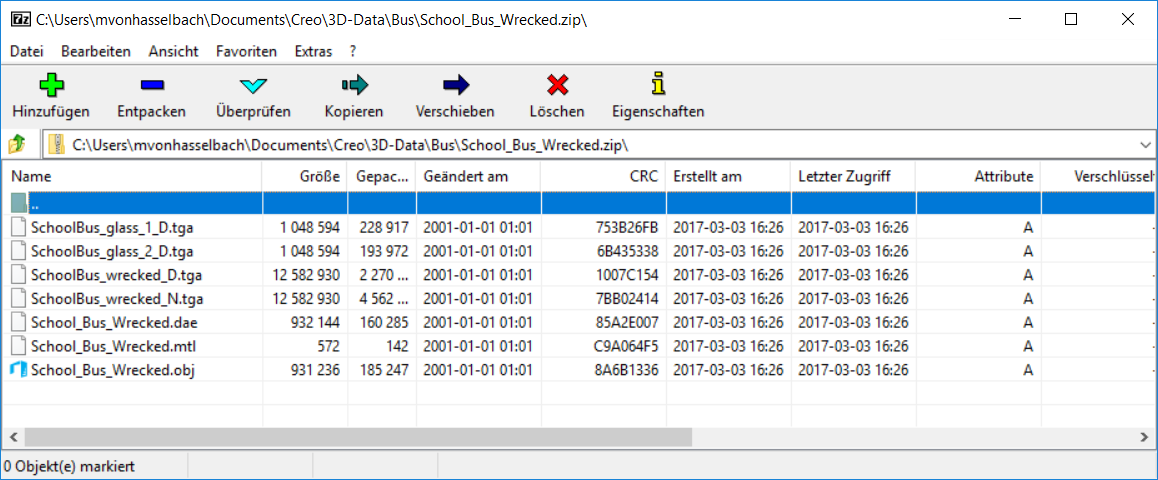

  2. you can use the obj format with textures. I tried it with the 1.9 version and found that it could only display the texture in the ThingWorx Studio Editor view. I'm not sure if the renderers in Preview and ThingWorx View already show it with 1.10 but it's worth a try. I had used this model for my test: http://tf3dm.com/3d-models/school-bus-wrecked/1/obj . You must create a zip with this content:
and then you can import it as TWX Studio resource.

I've not been able to get it to work using a ZIP file, but I can always get it to work using the following method:
1. Upload the MTLfile and all the images used for textures/
2. Upload the OBJ file and don't select the Run CAD Optimizer option
I've found that some of the models that I download from the internet are looking for the texture files in specific folders on the original uploader's computer.  So I open the MTL file in a text editor and remove any path information.  The textures and the OBJ file are then all in the same folder and I upload them into ThingWorx Studio as above and it works.
