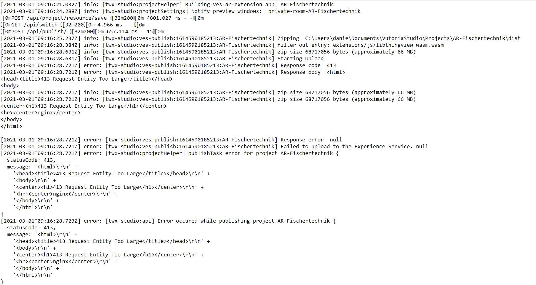

i want to publish a HoloLense Experience with some Thingworx Data, but i get this error in the studio.log file:
Why does it occur? 68MB shouldn't be too large for publishing?
Thank you very much!

It seems an error return by an nginx server.
So, I have a question :
  •   Where is located the Vuforia Experience Service ?
    • Is it a trial instance or an instance hosted at PTC Cloud or an on-Premise ?
Thanks in advance for your feedback.
Best regards,
Samuel

It is an on Premise Server

Try to publish again and look in Vuforia Experience Service log file.
  • If an error is thrown, it is an issue in Vuforia Experience Service
  • If no error or no verbose related to this Project, it is needed to check if an Nginx server is redirecting HTTP requests between Vuforia Studio to Vuforia Experience Service.
  • If it is correct, check log files in Nginx.
Best regards,
Samuel
