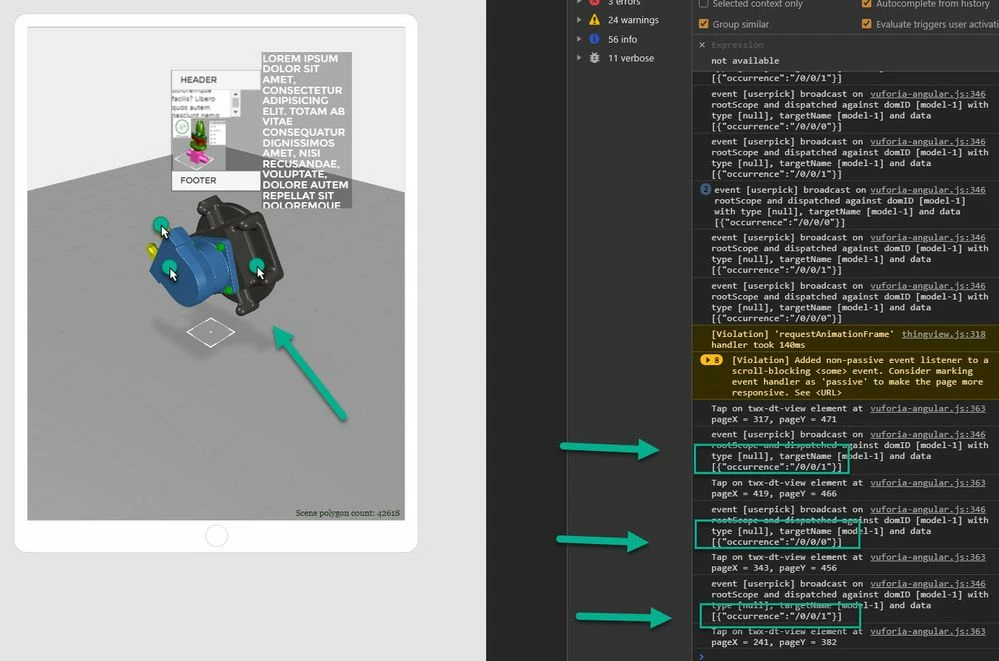

For example one test you can do:
Start you experience in preview and  press Strg +Shift +I - Keys to go in crome debuging mode and simple move the cursor about the model and click different components. What is the printing then?
Here an example:
So in the console we can see different occurance printing (means component Path Id)
