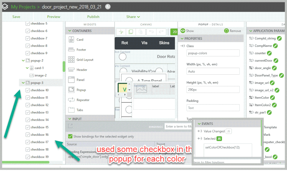

    Here we will change the color of particular model item using a pupup  with checkboxs and a slider for the same task
    For each checkbox we can simply define a function which will set a predefined color:
    In this case / here  we need to define for each color a separate function - some work intensive approach. Each checkbox has an separate class where we  can define the desired color  (in STYLES /Application) example:

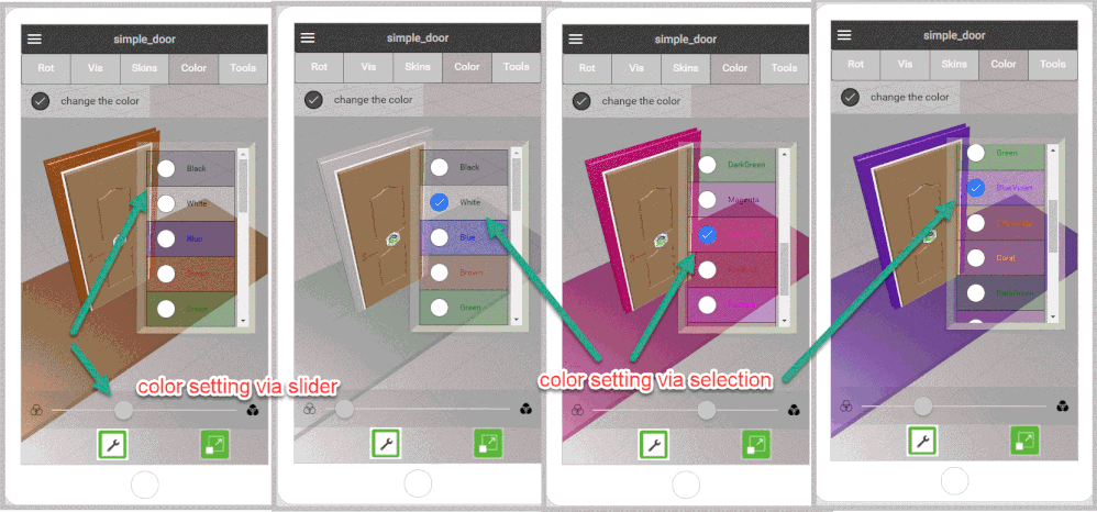

    The slider in the example have a binding to the value of parameter e.g. : app.params['ItemColor']
    When we change the value of the slider this will change the parameter ItemColor. Using a watch construct we can call a function when the value of the parameter changes e.g.:
    $scope.$watch( // watch for the color setting
     function() {
     return $scope.app.params['ItemColor'];
     function()
     $scope.setColorOfCheckboxGlob($scope.app.params['ItemColor']) ;
     //end of the second function
    The function will set the selected color to the modelitem and will update the checkbox settings. So, it will select the checkbox with the number corresponding to the value of the slider (it has the same range as the number of defined checkboxes for the different colors)
    So here it will pass simple the value of the slider to the function setColorOfCheckboxGlob()
